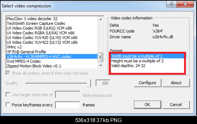

  8. Lone soldier Cauptain's Avatar
    Jan 2006
    Brazil
    Originally Posted by vinz508 View Post
    I cropped and resized the video, and was planning on saving it as .avi. But when it is already saving, I noticed that the file size was around 7GB...so I wanted to compress it. And it is also a h264
    Pay attention on this:
    Claudio

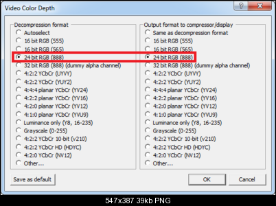

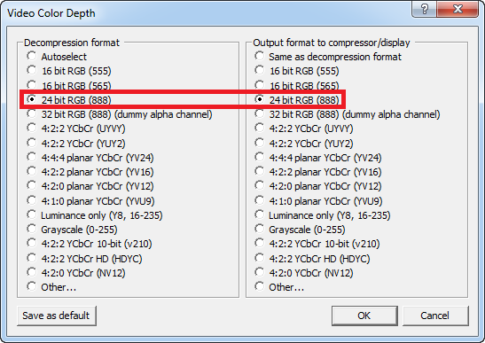

  12. Lone soldier Cauptain's Avatar
    Jan 2006
    Brazil
    On video tab, color depth, select this:
    Claudio

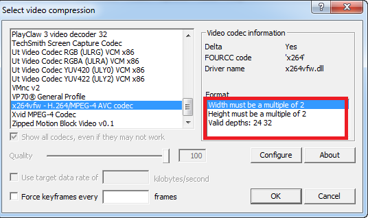

  14. Lone soldier Cauptain's Avatar
    Jan 2006
    Brazil
    I resized it from 535x299 to 642x359
    Ahhhh, X264 will work only multiply 2. Try 640x360 (16:9 AR)

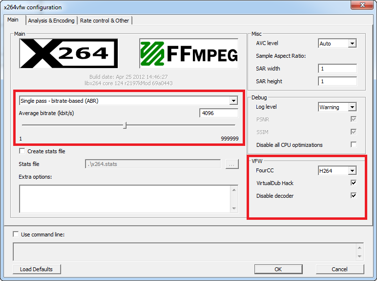

  21. Lone soldier Cauptain's Avatar
    Jan 2006
    Brazil
    If you resize to 640x360, select x264 and get error. Try this:
    Claudio
  22. Member
    May 2012
    Philippines
    works perfectly now...THANK YOU VERY MUCH cauptain!!!!!! )))

  24. Lone soldier Cauptain's Avatar
    Jan 2006
    Brazil
    one more question though, the original file size of the video was 118mb and after I cropped, resized and compressed it, it was around 600mb. why was it bigger???
    Simple. On AVERAGE BITRATE is select 4096 (medium bitrate) if you use small bitrate its will create a small file.
    Whats minutes is your video?
    Claudio

  26. Lone soldier Cauptain's Avatar
    Jan 2006
    Brazil
    its about 21 minutes
    should I use small bitrate??
    To get SAME original size, use 655 btr to video + 128 btr on Mp3 encode to audio. Its will 118MB file.
    Remember: more Bitrate = more quality = more size video.
    Claudio
