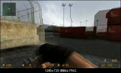

    This is what happens when I change my screen resolution to 1280x720 - https://forum.videohelp.com/images/imgfiles/bjIMZh.jpg
    The white "lines" were drawn by me to show how much screen room is missing due to a black border.
    Normal. go to videocard properties em set ASPECT RATIO and uncheck this.

    Tried turning off scaling, and scaling to aspect ratio when its set at 1280x720. Still has the black borders.

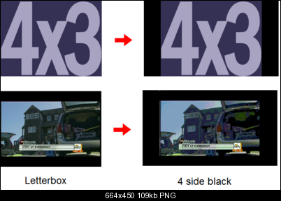

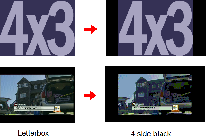

    What causes four side black borders? See this.

    I see your diagram, but I'm confused. I have the 4 side black. What is the diagram entitle about it?
    Four side black implies 4x3 letterbox is being displayed as 16:9.

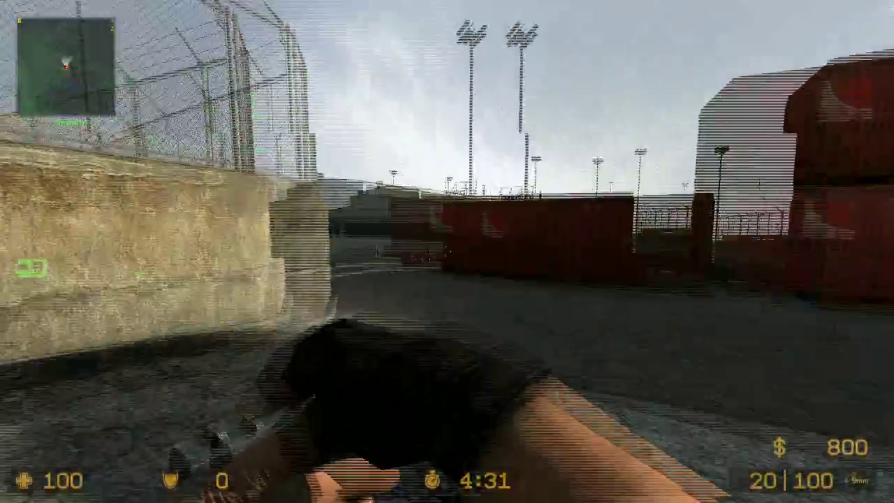

    What I WOULD like to figure out is the interlacing that you see happening on my test videos. Since I'm trying to put out nice quality videos, having the black lines across the screen randomly really isn't an option for me. I'm sure I could try to find the reasons why that's happening. I also haven't tested Motion JPEG yet, either. If you guys have any suggestions regarding the interlacing issue, I'd love to hear it, and I greatly appreciate all of your guys' help thus far. You guys have been a great help.
    Direct me to a picture?
    Black lines don't sound like "interlacing" but to inability to keep up with the data stream.

    The captured stream is showing frame blending (double vision) due to 60p->30p*. Also one of the frames is torn (light pole). The 1,986 Kbps bit rate seems excessive. Compress more until the tearing stops.
    Those aren't "black lines", every other line references a different frame in the original 60p stream.
    * The 60p stream should be frame decimated to 30p.
