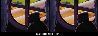

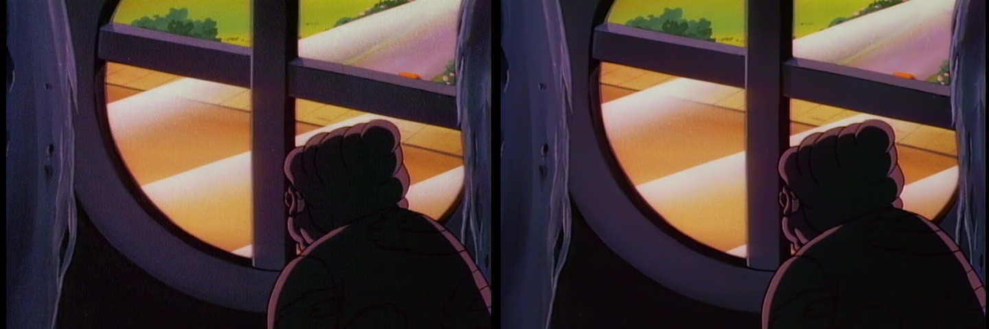

  5. Oops, I remembered your original post incorrectly and wrote this reply thinking you wanted to filter the grayscale areas but not the colorful areas... You should be able to extrapolate from this to get what you want...
    The actual value you want to subtract is 130*, not 128. I'm using mt_masktools to build the mask. I don't know if this is exactly what you want. It filters areas of low color saturation but not areas of high color saturation.
    Mpeg2Source("sample1.demuxed.d2v").TFM().TDecimate()
    umask=UtoY().BicubicResize(width,height).mt_lut("x 130 - abs").mt_lut("x 12 - 16 *")
    vmask=VtoY().BicubicResize(width,height).mt_lut("x 130 - abs").mt_lut("x 12 - 16 *")
    mask=Merge(umask, vmask)
    mt_merge(McTemporalDenoise(settings="high"), last, mask)
    Unfiltered on the left, filtered on the right:
    You'll have to play around with the mt_lut() values to get exactly the effect you want.

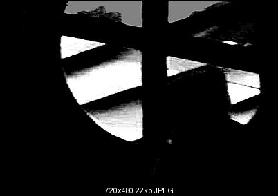

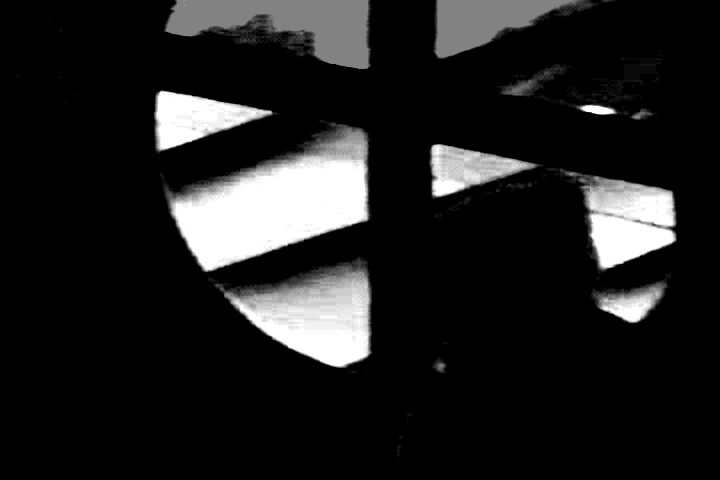

    UtoY() and VtoY() convert the U and V channels to Y. Since this is YV12 they have to be scaled back to the main clip's width and height. mt_lut("x 130 - abs") generates an image where anything that is gray gets the value 0, anything that has colors is >0 (ie, abs(y-130)). mt_lut("x 12 - 16 *") first subtracts 12 (basically a threshold amount of color) then multiples by 16 to accentuate the mask (ie, (y-12) * 16). Merge() blends the two masks together into one mask. Now anything that is (nearly) grayscale is black in the mask, anything that is colorful is white. Finally, we use mt_merge() to merge a highly filtered version of the video with a non filtered version of the video based on the mask. Here's what the mask looks like:
    If you want only the gray window frame and wooden planks filtered, but not the black parts of the picture, you'll have to add (and massage) the luma channel to the mask.

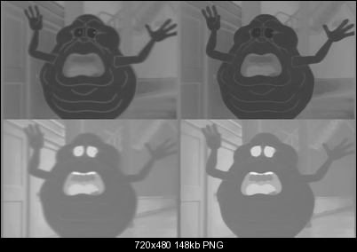

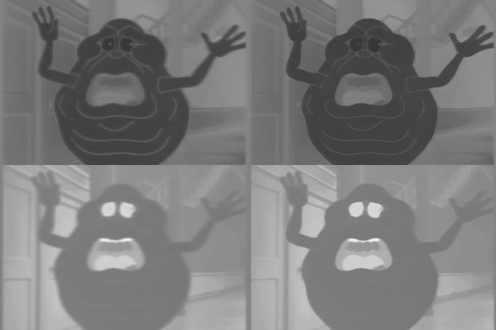

  19. Since your doing all that filtering you should sharpen the chroma channels and shift them left by a few pixels. Otherwise the filtered video looked pretty good.
  20. Banned
    Dec 2010
    New York
    No. That sounds silly and makes no sense.
  21. You really are an idiot and an *******.
    Unsharpened chroma on the left, sharpened on the right (U on top, V on bottom, from your "after" video):
    Alternating original, sharpened chroma sample:
