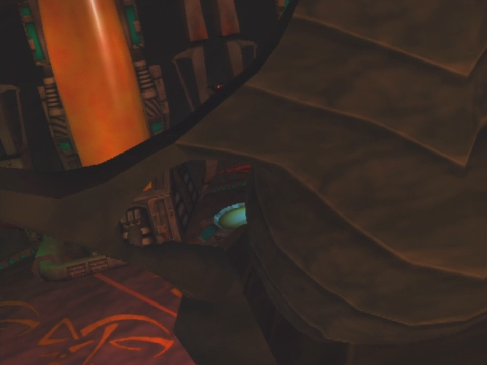

    On scenes in the game with long, slow movement, colors in the final render become blocky and "stuck". They eventually "reset", resulting in a noticeable "bump" in the color of the background. Here are some relevant screenshots:
    source .M2TS File straight from the capture card:
    here is an image of the playback of the final MP4 in VLC:
    As you can see the picture has accumulated some blocks
    here is a second later, when everything has snapped back to correct color:
    I am working on a test video to illustrate this but it will take a few, as I am on the way out the door at the moment.
    I have no idea what could be causing this, but it's a real drag. I am trying to use the 64 bit versions of all the AviSynth plugins from the workflow I posted, however I'm guessing I may have botched the installation. Here is my AviSynth plugins folder:
    And a look at my H264 settings (perhaps 2 pass rendering is to blame? Not sure, still testing)
    I would appreciate any insight anyone can give me, and I tried to make the process as easy as possible, with lots of information and screens.

  2. Ah, actually, I seem to have fixed it.
    While I made this post, I was rendering a test out with the settings posted above. The only thing I had changed was the deblocking value - I had previously left it at 0. (So to clarify, the screenshots are with --deblock 0:0)
    I guess I'll render out a final "test" video, one with deblocking on and one with it off and see if people see the same thing I see.

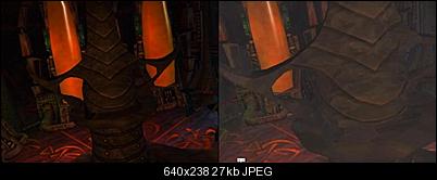

  3. Why are the colors and levels so different between the original M2TS file and video you encoded?
    You should switch to CRF encoding. It's faster and you always get the quality you specify. There's no guessing what bitrate is required for each video.
  4. My understanding is that that's the result of converting to YV12.
  5. Originally Posted by Deadpangold View Post
    It's not, or you did it incorrectly.
    This is a levels issue. Either you have vegas setup incorrectly, or you converted to YV12 incorrectly (wrong matrix), and/or you have playback issue (either renderer, or graphics settings)

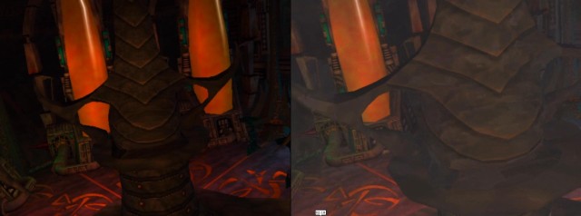

  7. Originally Posted by Deadpangold View Post
    These colors have always looked a bit off to me.
    A bit off? Are we looking at the same pictures? The first two images from your original post (original, reencoded):
    That's much much more than a PC vs. REC or 601 vs. 709 matrix difference.
  8. No, I guess we're not. I thought you meant the THIRD picture, which is how it's supposed to look.
    The second picture occurs sporadically, that was my question, "why is this happening sometimes".
  9. My point was that if your source looks like the first picture, and your encoded video looks like the second and third pictures, you have a severe problem. Not just a conversion matrix or encoder problem.
  10. Ah, I see.
    I made the changes from above to the avs script and now I have this (still in VLC)
    Not sure if this is better or worse, and I have no ideas other than that person who mentioned it being a playback problem being correct, since the flicker/color jump doesn't occur on WMP
  11. That's better but it still looks nothing like your first picture. Look at the darkest blacks. In the first picture they're near pure black (RGB~=5). In all the other pictures they're gray, RGB~=30 in the second and third pictures, RGB~=20 in the fourth picture. Is this just because the scene changes (your posting different frames in every picture) or a result of your processing? If the black level difference isn't obvious to you, you should calibrate your system.

  13. Ah, ok, yes, I think I see. Putting the pictures right next to each other really helps.
    Is the MeGUI preview generally very accurate? if so, I should have this on the next render:
  14. I don't know about MeGUI's preview, but that shot finally has the same levels as the first picture.
  15. Seems to be so, yeah. Render came out looking like that.

  18. If you use vegas in 8-bit mode, most native camera formats like AVCHD, will use "studio RGB", so full range YUV => RGB conversion. So when you frameserve RGB out, you need to convert to YV12 using PC.709 matrix to expand the levels back to "normal" . YV12 using Rec matrix will show picture with elevated black level, looks "washed out" (like your screenshot"
    But there are dozens of different reasons why you could be having problems. Renderer, GPU settings, method of taking screenshots
  19. Yes, using ConvertToYV12(interlaced=false, matrix="PC.709") should bring the black level down (and the white level up) to match the original video.
