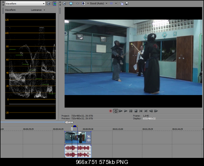

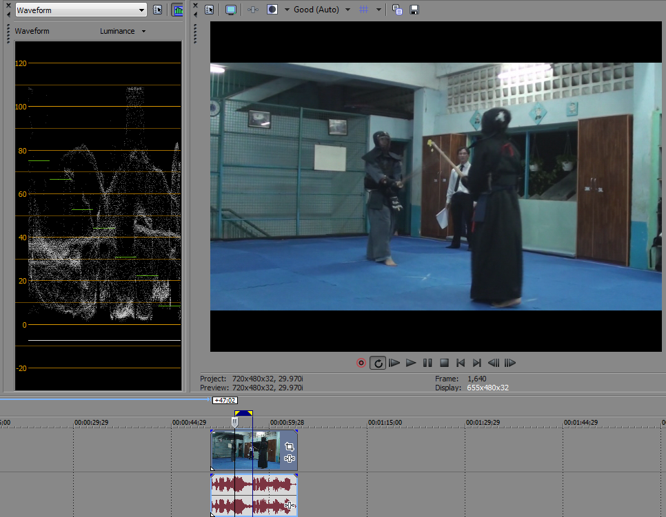

  2. Member edDV's Avatar
    Mar 2004
    Northern California, USA
    How are you viewing the file?
    How does it look if camcorder is directly connected to a TV?
    The exposure is typical for Sony consumer camcorder (16-255 nominal). However it is not "dark" since there is no true black in the scene.
    What is lacking in this clip is additional lighting to define the dark garments up from the dark window and background. You can play with gamma but the window will also get brighter. You need to light your characters to lift them out of room light. Side lights will help define a brighter edge vs. lifting all luma values.

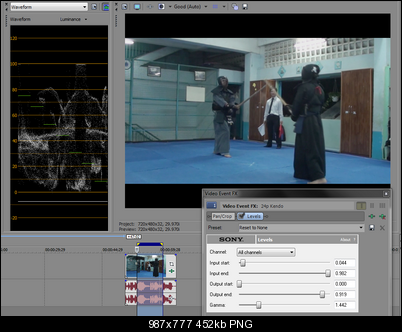

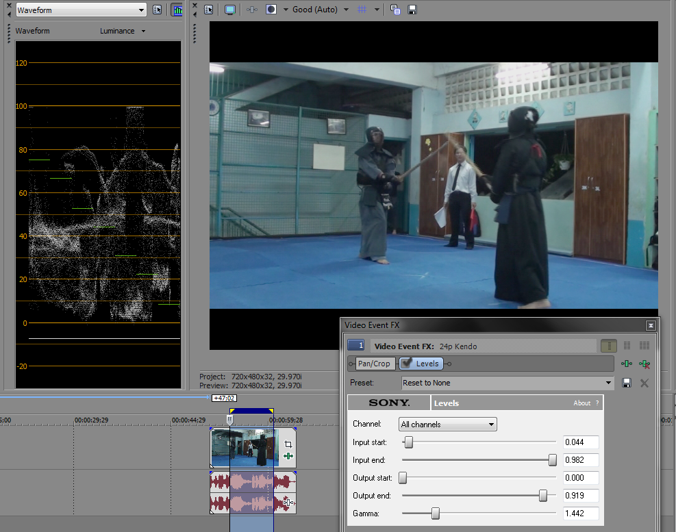

  3. Member edDV's Avatar
    Mar 2004
    A bit of fiddling with the levels filter.
    Verify results on an HDTV.
    http://www.kiva.org/about
