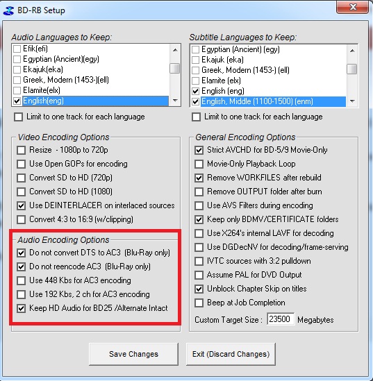

    I did once after a fresh install, I forgot to check the options/setup.

  3. hi thanks for the reply
    yep, i have it set just as shown! hence why im stumped.
    still losing the 5.1 pcm lossless stream though.......done 2 movies from my collection and both just have the ac3 448kbs streams.

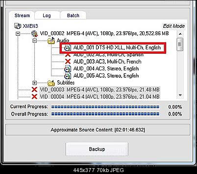

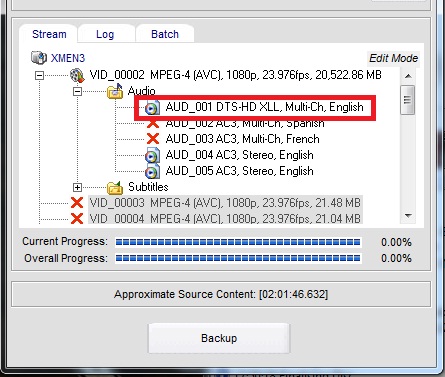

    Are you making sure that more than one english audio stream is checked in the Audio Languages To Keep box ?
    I seem to recall when i only had one checked, it would automatically blank the others out,
    Make sure in the main screen the one's you want to keep are not X'd out.
