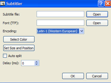

    There might be differences between windows version and other os's of avidemux, or you might be using an outdated build, not sure. These are the options in the SRT filter . Size & position opens up a sub window where you set the horizontal and vertical placement
