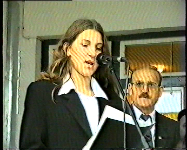

    Can you help me identify VHS artifacts on this pictures. These tiny but thick vertical lines, they are all over the video. They do not show when I hook my VCR directly to LCD TV. Also, if you see any other distortions that can be fixed with filters.
    I use Samsung 6 head VCR (probably no TBC) + Sony HC32E camcorder to transfer analog to digital.
    Which virtual dub filter do you recommend?
    Thank you.

  2. You have severe luma/chroma crosstalk. The chroma channels are leaking into the luma channel. The capture card isn't separating luma and chroma properly from the composite signal.
    May 2012
    Croatia
    I do not use capture card, I use Sony camcorder. And signal is fed to Sony camcorder through S-Video cable (VCR-scart-S-VIDEO-Camcorder-firewire-computer).
    You recommend new converter device?
  4. I'd say your s-video cable is faulty. It seems to me you are using a normal vcr (not s-vhs) and should use a composite cable instead

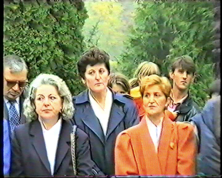

    It looks that luma/chroma crosstalk is gone, but image lost it sharpness. Is there any filter for this? Should I get better S-Video cable and try again? Problem might also be in my SCART TO S-VIDEO converter. Or should I stick to composite?
    PS:
    Here is new screenshot. I do not think that I can get more than this out of this tape. Maybe I should stick to composit?
    Notice the colorless space on the right. That is probably because of composite cable?
  7. I don't think the problem is in the cable. If I understand your post correctly
    you are using a SCART to s-video adapter. The problem is probably in that adapter.
