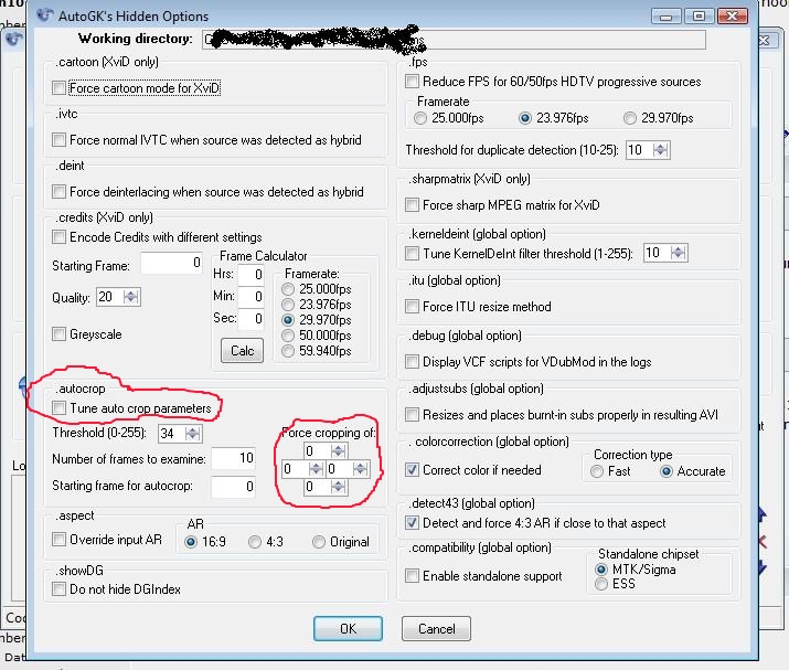

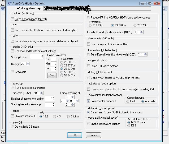

    Hi i held ctrl +f9 and this came out . where do i assign the new size ? i can't see force cropping option also .

  9. they renamed a few thing since I last used autoGK a few years ago,..
    - enabled '.autocrop->tune auto crop parameters'
    - set the cropping in the cross under '.autocrop->Force cropping of:'
