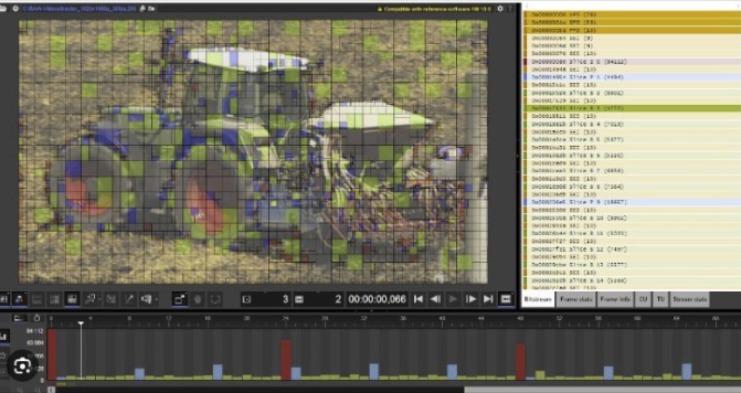

Great news for video enthusiasts. SolveigMM professional video debugging tool ZOND 265 with HEVC,AVC,AV1 on board gets a free plan!
If you know or want to learn what is HEVC, AV1, AVC, bitrate, macroblocks, motion vectors thats the tool
[Attachment 79070 - Click to enlarge]
http://www.solveigmm.com/en/products/zond/Regards,
Dmitry | SolveigMM | Smart Video Editing (H624/MPEG-2/...)
