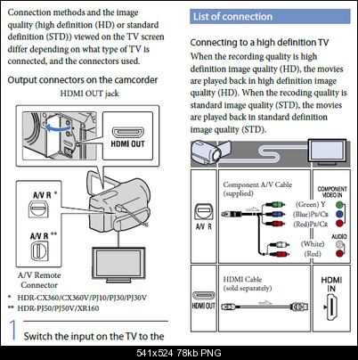

    Are you talking about the analog A/V R port?
    P-33 of your manual
    For that you need a BlackMagic Intensity Pro but that won't work in a Mac. Elgato makes an HD component capture device for Mac.

    Analog component YPbPr video and RCA type stereo audio. Both lower quality than HDMI or AVCHD file transfer.
    The round minijacks are probably headphones and external mic.
    Didn't you get a manual? You can find one here.
    http://www.docs.sony.com/release/HDRCX360V-PJ10-PJ30V-PJ50V-XR160_handbook.pdf
