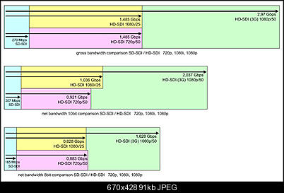

  22. Lone soldier Cauptain's Avatar
    Jan 2006
    Brazil
    Originally Posted by vaporeon800 View Post
    ^ You're saying the Hopper doesn't encrypt its HDMI output for regular viewing?
    Regarding hard drive set up... Capturing standard definition interlaced content with a lossless codec creates file sizes in the neighborhood of 30-40 GB/hour. Losslessly compressed HD files from the AVerTV HD DVR PCI-e card would be 5 1/3 or 6 times larger. Capturing that amount of data successfully requires a RAID array.
    When using Ut Video, it's around 100GB/hr for 720p60, 1080i60, and 1080p30 in my experience. I think my SD recordings are more like 25GB/hr. No RAID required, provided you aren't trying to record a deliberately noisy test pattern.
    In theory its necessary, but in theory. I record 720p with UT Video and RAID and normal HD, no problem.
    720p: the image in the 720p60 format has about 0,922 megapixels per frame (1280×720), with 24-bit color per pixel (RGB) and 60 full images per second it needs a bandwidth of about 1.30 Gbps.
    1080i: the image in the 1080i60 format has about 2.07 megapixels per frame (1920x1080), with 24-bit color per pixel (RGB) and 60 half-images per second it needs a bandwidth of about 1.46 Gbps.
    1080p: the image in the 1080p60 format has about 2.07 megapixels per frame (1920x1080), with 24-bit color per pixel (RGB) and 60 full images per second it needs a bandwidth of about 2.97 Gbps.

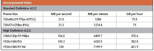

    Standard Definition
    Frame Size                  MB/second       MB/minute      GB/hour
    720x486/29.97fps (NTSC)       21.5            1288          75.5
    720x576/25fps (PAL)           21.2           1274.4          75
    High Definition
    1280x720p/59.94fps            106.8          6409.7         375.6
    1920x1080/50i                 100.3          6020.5         352.8
    1920x1080/59.94i               120           7199.9         421.9
    source: http://www.avsforum.com/avs-vb/showthread.php?p=18254633#post18254633

    Sustained transfer rates are more in the 90-120 MB/s range for a typical hard drive and this varies for the inner vs outer end of the drive platter. You would need to move to a 10K or 15K RPM Raptor to attempt single disk capture. Best to use a two disk RAID0. A RAID reads one disk from the fast end and the other from the slow end to average to a combined 2x rate over the full range of the drive.
    Here are the uncompressed data rates for a BlackMagic Intensity.
    Keep in mind that 1MB/s is equivalent to 8 Mb/s (Bytes vs Bits).
    And yes, 1 hour of uncompressed 1080i takes up 421.9 GB !
