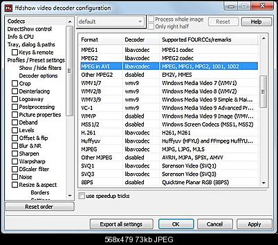

  4. You could probably play the original file if you install an "MPEG in AVI" decoder. ffdshow has one.

  7. Normally, Start -> All Programs -> ffdshow -> Video Decoder Configuration. To open such file in VirtualDub you need to configure Start -> All Programs -> ffdshow -> VFW Configuration.
