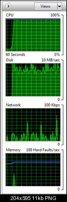

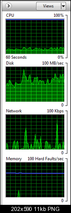

    In resource monitor you will see the graphs peg or memory showing hard faults. Here is a simple example.
    This is an SD DV low render (audio only) transfer in Vegas from DV video on one drive to another. As you can see, physical memory used (blue line) is 70% used with no faults and the CPU and disk drives are running ~70-80 MB/s but still could go faster.
    Here is an SD DV to h.264 encode in Handbrake. Note that physical memory used went up (Vegas still open) but still only 80% used. CPU is pegged which is normal during an encode. the disk drive is well within spec at ~11 MB/s. Now if this were an uncompressed file, the disk drive would be pegged and the CPU would be less than 100% waiting for data from disk.
    The network activity is unrelated. I'm watching a podcast at the same time.

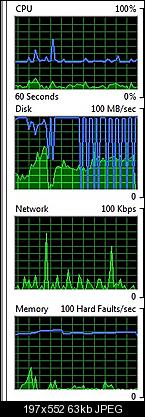

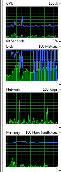

    This is the graphs with only AE running, this was taken during one of the moments of the program freezing.
Name:	Graph image.jpg
  12. Member edDV's Avatar
    Mar 2004
    Northern California, USA
    Obviously a disk access problem. Is this a single disk laptop?
    The green line shows disk transfer rate. The blue line shows disk activity.
    http://www.techrepublic.com/blog/datacenter/use-resource-monitor-to-monitor-storage-performance/4233
