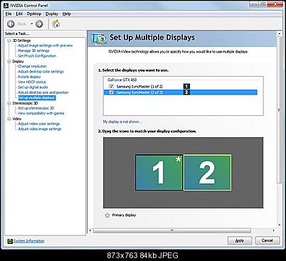

  6. Make sure you drag WMP off the correct edge of the main monitor. Or change the orientation of the two monitors in the graphics card's setup applet to match their physical locations. Drag/drop the monitors around:
    Here the second monitor is to the right of the main monitor so you would drag WMP off the right edge of monitor 1 to get it to monitor 2.
