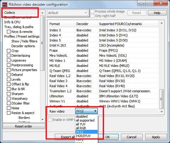

  13. Originally Posted by blud View Post
    Couldn't locate decompressor for format "YV12" (unknown)...
    ffdshow includes a YV12 "decoder". Start -> All Programs -> ffdshow -> Video Decoder Configuration...

  16. Originally Posted by jagabo View Post
    So are you saying I need to install ffdshow? (I'm confused why you show that picture.)

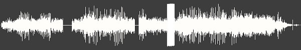

    Oct 2010
    England
    The type of glitches I am trying to spot would most likely be seen even with 7 out of every 8 frames cut. Like, the vcr would go to a blue screen for a half a second or so, or the audio would go like BRUUPPPBRUPPPP loudly.
    Is the audio always affected when you get these glitches? If the audio goes wrong in an obvious way (silence or static) you might be able to spot the errors just by looking at the audio waveform:
    ...not that it matters, but I originally missed where you said the videos were MPEG2... and MPEG2 certainly isn't a 'modern codec'... But I'm still not surprised that you're having problems trying to play at these speeds.

  22. Originally Posted by intracube View Post
    [Attachment 12316 - Click to enlarge]
    No, unfortunately the potential audio issues are probably too random for that. (sometimes quiet, sometimes loud static). I mean, I could probably find a bunch of it that way, but, I don't even think Vegas can load these files and if it could they would probably be all slow and annoying. (Vegas being the only app I have where I could see those wave forms.)
