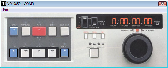

    Just for the heck of it, I recently wrote a bit of software to control my U-matic deck, which is uncomfortably far from my keyboard. With the Hexin USB-->RS422/485 converter ($25), it works just fine. My program is designed for mouse control, but could be modified to accept key commands from the Shuttle as well. I have the Xpress, so maybe I'll give it a try.
Name:	VCR Remote.jpg

    [Attachment 12602 - Click to enlarge]
    That's very interesting! Unfortunately I have no software programming experience but if I had such a program to control the Panasonic DS840/850 decks I have, that would be cool. I can get a 422 serial interface card for my PC and connect it to the deck.
    Give it a try with your Shuttle Xpress and see how it works out. If it works, maybe perhaps there could be a way to adapt it to work with the Shuttle Pro as well.
