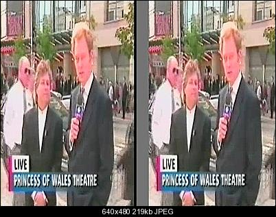

    I was backing up some old Television DVD's to AVI using DVD Fab and encountered two problems.
    One was that the output AVI had replicated the video, so it looks like this.
    The other, I encountered only in one DVD, and the output AVI had only captured about 70% of the screen (as if it had zoomed in, and encoded only three fourths of the video)
    Any help would be greatly appreciated, thank you so much!

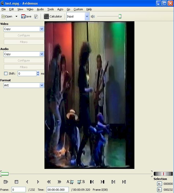

    Most likely the video on your DVD is similar to this:
    Video
    Format : MPEG Video
    Format version : Version 2
    Width : 352 pixels
    Height : 576 pixels
    Display aspect ratio : 4:3
    Frame rate : 25.000 fps
    Standard : PAL
    Color space : YUV
    Chroma subsampling : 4:2:0
    Bit depth : 8 bits
    Scan type : Interlaced
    Scan order : Top Field First
    Bits/(Pixel*Frame) : 0.498
    Stream size : 2.82 MiB (88%)
    Audio
    Format : AC-3
    Format/Info : Audio Coding 3
    Duration : 9s 440ms
    Bit rate mode : Constant
    Bit rate : 256 Kbps
    Channel(s) : 2 channels
    Sampling rate : 48.0 KHz
    Bit depth : 16 bits
    Video delay : -40ms
    Stream size : 295 KiB (9%)

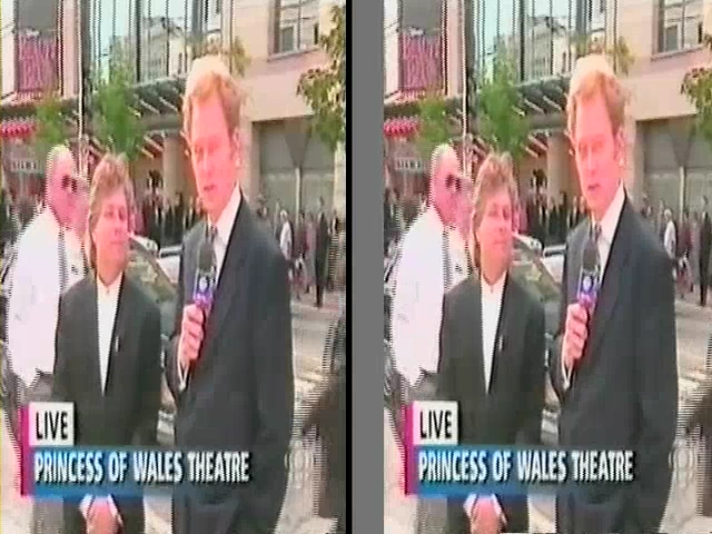

    I ran a sample of mine through WinFF(changing the output video to 704x576)
    and it created this:
    https://rapidshare.com/files/1837144329/HalfD1test.avi
    The audio is also still in sync.
    You MAY however want to use VOB2MPEG (FREE) on that disc first to create one, large VOB(MPEG) file....then run it through
    WinFF.
    As stated...both WinFF and VOB2MPEG are FREE and contain no junk spyware or adware.
    Also beware that sync problems were pretty common with older DVD recorders when trying to process the material afterwards in a computer(as you are doing). You have a "double whammy"....HalfD1 and what appears to be a disc made with one of those recorders that creates sync problems during post-processing.
