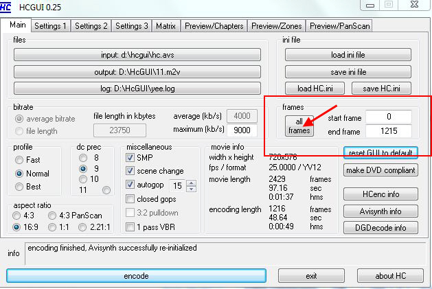

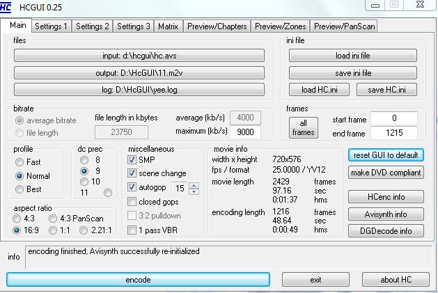

    But still the same problem, it writes:
    Movie Length: 2429 Frames
    Encoding length: 1216 Frames
    And when I press encoding, it only starts encoding 1216. It doesn't want to do the full movie.

    here are 2, log file will come soon
  6. do you see on the right hand side, where it says frames? you have 0-1215 selected. Push "all frames button"

    I cannot believe it.
    But you didn't tell me I have to press that button a few days ago, when I asked you about what I have to set on HcGUI for encoding. If I know that, maybe there wouldn't have been this s.ck.ng...
  8. Originally Posted by Bencuri View Post
    Sorry, I didn't look at any of your videos or settings in this thread until today
    By default, all frames are selected in HCEnc. You must have purposefully set that range

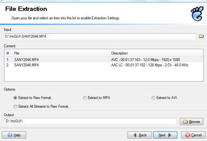

    So this 128 Kbps is the camcorder's recording rate that you can see at the description? See the file I attached of my Yamb window.
  29. Originally Posted by Bencuri View Post
    Yes that's what your camera records at - 192kbps is the peak bitrate, its a VBR recording
    Bit rate mode : Variable
    Nominal bit rate : 128 Kbps
    Maximum bit rate : 192 Kbps
    The quality loss occurs when you encode it for something compatible for DVD-video (like mp2 audio, or AC3 audio). You can minimize that loss by using higher bitrates. Yamb doesn't re-encode (no quality loss)
