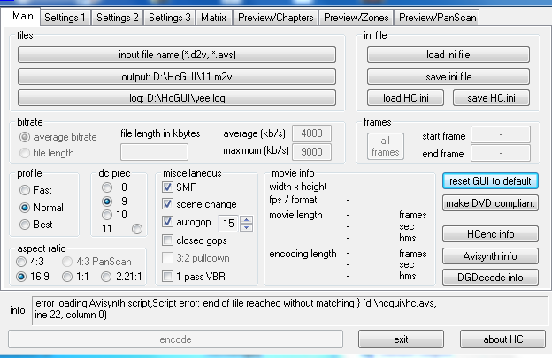

    Anyway, the script is still not good. HcGui says: could load Smoothfps.avs. I don't have that file in the plugins. Which filter does that belong to?

  7. Originally Posted by Bencuri View Post
    I am asking that I splitted the file, I have a shorter first piece now to do these tests. It takes very long to test with the 5 minute file, evey conversion takes 2 and a half hours. It is making me nervous. So I made a smaller piece, I guess I have to add a different trim value. How can I calculate it?
    By the way, couldn't all this conversion be solved in After Effects? I have downloaded the trial version, I guess if it is possible to do this there, that has all the components that is needed, so what if I'd try that?
    If you 've already cut the file shorter (for a small test), don't use trim() at all. It's already small enough, correct ?
    For .avs files you have to use Import() to load them, not LoadPlugin(). Or just copy & paste the function to the bottom of the script. Smoothfps uses mvtools2.dll , so either autoload it, or LoadPlugin() in the script
    Yes, it's possible to do the retiming in AE, but it will take you a while to learn the basics. But the deinterlacing quality is very poor compared to avisynth (might not matter as much since you are resizing to SD DVD). The interpolation is also many times slower than mvtools2 (but not necessarily better quality, unless you use 3rd party plugin, twixtor)

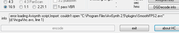

    Where did I put? I have no clue! I don't know at all what file is that!
    Here is the code that jagabo gave me:
    Import("C:\Program Files (x86)\AviSynth 2.5\plugins\SmoothFPS2.avs")
    Load_Stdcall_plugin("C:\Program Files (x86)\AviSynth 2.5\plugins\yadif.dll")
    DirectShowSource("1z.MP4", seek=false)
    AssumeTFF()
    AssumeFPS(30000,1001)
    Trim(0,10497)
    Yadif(mode=1, order=1)
    LanczosResize(720,576)
    SmoothFPS2(50,1)
    SeparateFields()
    SelectEvery(4,0,3)
    Weave()
    The error is regarding the SmoothFPS2.avs. I don't know where it is, because I haven't met this file in my life, LOL!
  11. Just copy it to the bottom, erase the import line
    The function SmoothFPS2 is defined by those lines at the bottom
    If you copy just that section, alone in a .avs file, saved it , then placed it somewhere, then you could use Import()
    If you are using different file, change the path & filename. If you dont' need the Trim(), erase it, or comment it out (place "#" in front of the line)

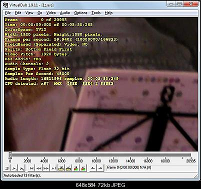

    Jagabo set the trimming, because the software detected 2x more frames as should have, so are you sure the new file won't be a problem? When I open the new file I have created from the original mp4, the short file, that's length is also not detected correctly. Are you sure trimming is useless?
    Reconsider it, and if trimming is needed, tell me how I can calculate what value to write to trimming. If I succeed, I have 6 more mp4 to process, because all this is a full concert, I will have to know how to determine the correct trimming value.

  13. Originally Posted by Bencuri View Post
    Are you sure it was 2x more frames, not twice the frame rate? Didn't jagabo say the problem was with your directshow filters?
    The file should have 8756 frames. It's about 5 minutes and 50 seconds long, ie 350 seconds. Multiplying by 25 fps gives 8750 frames. It's DirectShowSource() that is screwing up.
    Eitherway, if you have 2x more frames, using trim() is the wrong thing to do. If they were doubled up, you would select every 2nd one, not cut off a piece linearly from A to B
    I didn't download any of your files, except for the one in the other thread, so I'm not sure what's going on. I know the framerate of the header is incorrect in that file

    The essence is that HCGUI detected 2x more frames at the actual amount in the file. After conversion, there was a long period in the file where there was no action, but a still image. And not the whole action was converted, from a 5:50 file, only 5 was action, the other 5 minutes were still image. From 5:50 minutes of concert, the result was 5 minute concert, 5 minute still.
  15. Originally Posted by Bencuri View Post
    Likely, it's a problem with your directshow filters, not hcgui problem
    If you open the avs in vdub, and move the playhead, problem still exist? If so, it's likely problem with your directshow setup
    If the 1st half was fine, then 2nd half repeated, then that could be a valid reason for using trim()
    You would cut the 2nd half off with Trim(). The numbers you would use would be the point it starts to loop

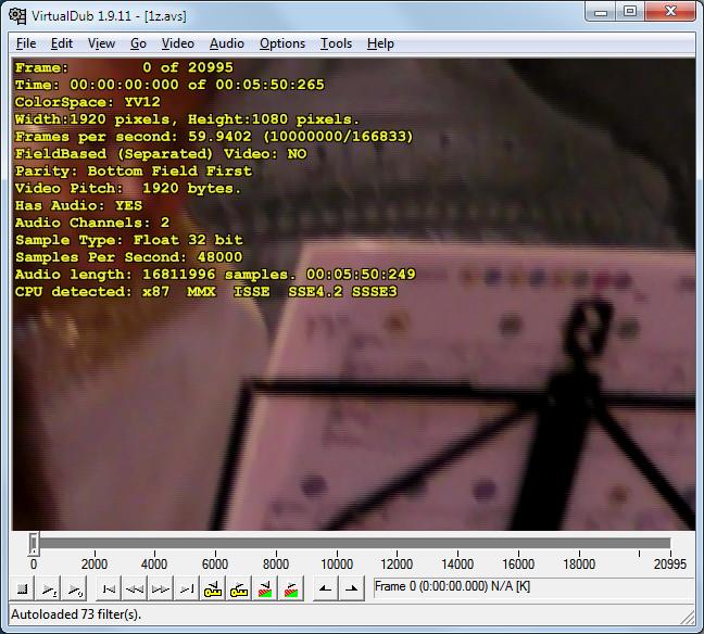

    VirtualDub is also making error. It detects 2x more frames.
    Actually the conversion was not a half full action, half still converstion. What happened:
    There was a 5:50 long mp4. HcGUI detected 11 minutes, 2x more frames as should, but the converted file was like that: 5 minutes were converted from the 5:50, the rest 5 minutes in the new file was still image. So there was a 10:00 file as outcome, it contained 5 minutes action from the original, the rest is still. Not like 5:50 action as original, and rest is still. There was always a small portion in the end it didn't convert. So I am not sure this trimming will be useful, because the problem is not that simple.

  18. The point is, neither vdub or hcenc are the problem. The problem is likely your directshow splitter and/or decoder
    Ok, I'll have a look at the new file in post #102 . Is this new file giving you same problems (with the still image)?

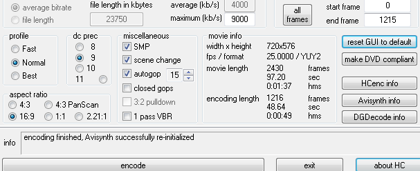

    Is this normal?:
    HCGUI says: 4xxx frames in file
    Encodeing length is half of that. When I press encode, it starts encoding only half. What the hell is it doing? Is it normal????

  22. Encodeing length is half of that. When I press encode, it starts encoding only half. What the hell is it doing? Is it normal????
    No not normal. It can only encode what you give it. You give it messed up file, so it encodes messed up file

  28. Attached is SmoothFPS2.ZIP which contains SmoothFPS2.AVS. Extract the file and put it in your AviSynth plugins folder. I had previously copied athe function out of that file, and pasted it into the script I gave you.
    I was unable to find any combination of source filters and codecs that would correctly handle the MP4 files from that camcorder. The best I could come up with was DirectShowSource() which resulted in 2x the frame rate and 2x the number of frames. Ie, the original video was 10497 frames and 29.97 fps. But DirectShowSource() returned 20994 frames and 59.94 fps. Since the video didn't contain any frames beyoud 10497, frame 10497 was repeated over and over for the second half of the video. My solution was to use AssumeFPS() to fix the frame rate, and Trim() to remove the extra frames.
    If you want to see how many frames your video has you can use MediaInfo. It reports the same 2x that DirectShowSource did. You can also use Info() in an AviSynth script.
    DirectShowSource("filename.ext")
    Info()
    That will report (overlay text within the video) a lot of information about the file, including the number of frames and the frame rate:
    As poisondeathray pointed out, DirectShow is Windows' A/V subsystem. Using DirectShowSource() is asking Windows to open and decompress the video file for you (as opposed to something like AviSource() where AviSynth itself opens the file, splits the video and audio into separate streams, and decompresses them using installed VFW codecs). Exactly what combination of filters is used will depend on what you have installed on your system. At the start of this thread I was using LAV Filters. But later I switched back to Haali and ffdshow to see if there was any improvement. There wasn't much difference as far as this video was concerned. I also tried using the old version of ffms2 which screwed op some of the feilds/frames, and a newer version which locked up completely. I also tried using Core AVC as the decoder.

    Okay, project with Yamb done, wonderful software, it is fast.
    I used this code you wrote here above. It doesn't work, see the outcome attached.
  30. Your screenshot shows no .avs loaded
    Make sure you copy & pasted it correctly, and changed the 1st line.
    Open the .avs in vdub, what does the error message say?
