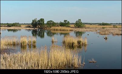

    You'll probably have to click on the image a three times to see the full resolution of the image.
    Keep in mind that TVs are designed to deal with interlaced video and know how to handle it. They also typically apply sharpening filters. Go to your TVs controls and disable the sharpening and edge enhancement filters. Is the picture closer to what you see on the computer?
    Computers monitors generally deal with progressive video and they make no attempt to enhance the sharpness -- normally the picture is already sharp (the Desktop, for example). Any attempt to sharpen the Desktop would make it look worse, not better. Interlaced video sources have to be denterlaced. The quality of the deinterlacing varies from program to program, graphics card to graphics card.
    Other things might make a TV appear sharper than a computer monitor. For example, enhanced contrast will make the video appear sharper. Again, computer monitors are not supposed to change the contrast, but TVs typically do.
    Generally, if you want the computer to display the video more like your TV you'll have to use player software that applies filters similar to those a typical TV uses.

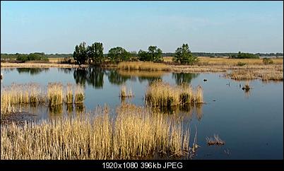

    Is this image more like what you see on your TV?

    Yes, this is definately very close to what the TV displays.
  10. Originally Posted by Bencuri View Post
    You mean the second image? If so, it's just a matter of the TV sharpening the image and enhancing the contrast. Most media players have the ability to make such adjustments. Or you can make them in your graphics card's setup applet.

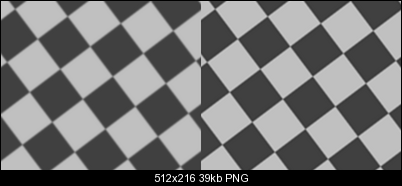

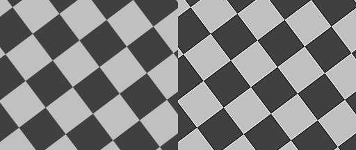

  22. The problem wasn't that your computer wasn't sharpening enough. It was that your camcorder doesn't produce very sharp pictures and your TV is over sharpening. You're adjusting everything else to make up for the camcorder's deficiencies. If you were to watch very sharp video on your TV with the same sharpening settings you will see oversharpening halos and increased noise.
    A blurry image (left), sharpened (right):
    A sharp image sharpened by the same amount:
    Notice how the transition from dark gray to light gray is no longer smooth. There is an overshoot to black and white -- halos.

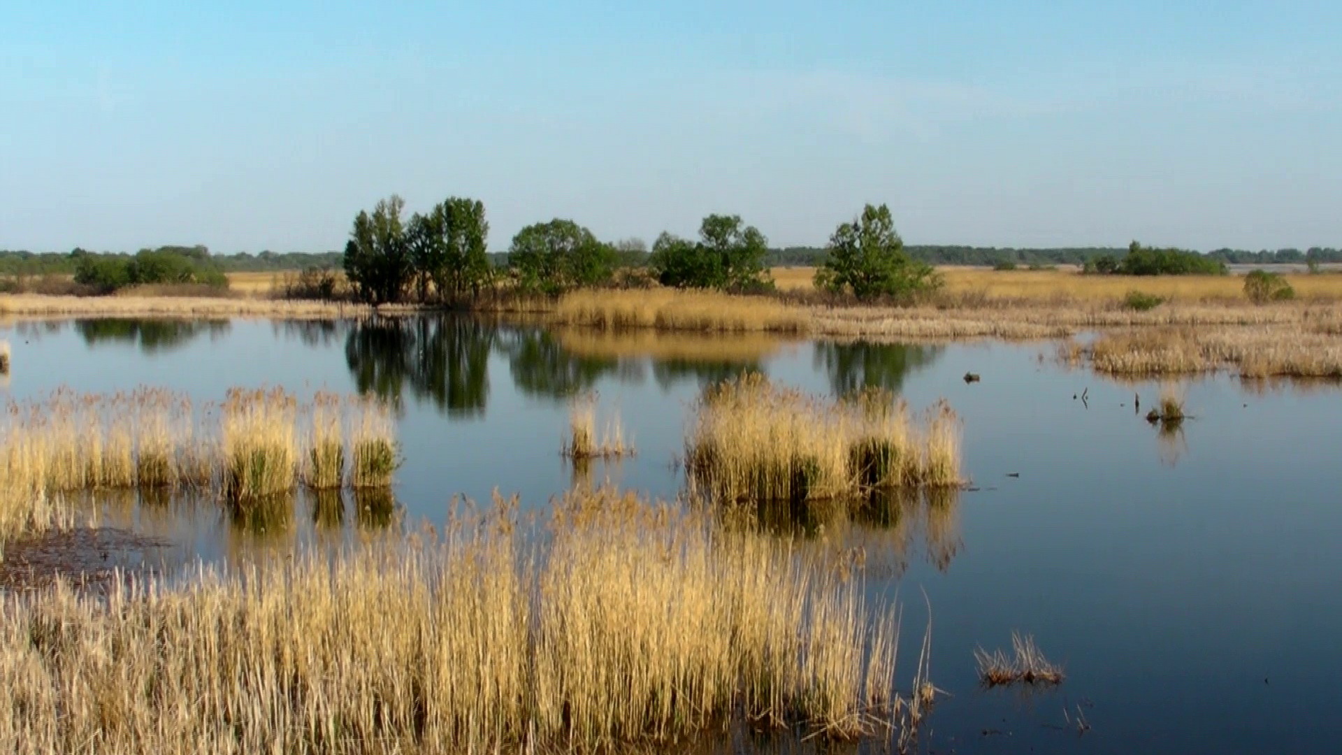

    I couldn't find a way to upload a sample of this flcikering, but I guess you can also observe it on your machine. Run the video I linked for the second time: http://www.zshare.ma/a4zndv5bmpsv
    This is the camcorder video.
    Turn on sharpening to maximum. And you will se flickering, I guess. I attached a photo about a moment at 00:37 in the video, I marked where I see the flickering. There are other portions flickering at different moments. I am talking about these.
    You don't have to set that strong sharpening so that the picrute would start flickering, but with this extreme setting you will surely see what I refer to.
    Can these be eliminated?
