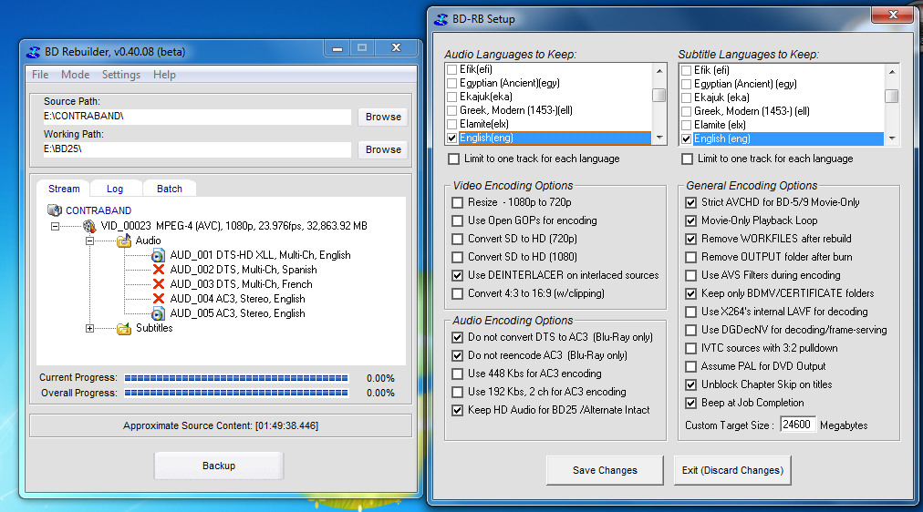

  5. I used anydvd version 7.0.3.0 with bdrb in main movie only mode and had no problem backing it up.

    If the OP is trying to backup the entire thing including extras, my previous post still applies. I've seen quite a few BD discs where the movie is a normal H.264 file like in mrawla's post, but the extras are various combinations of interlaced VC-1 and MPEG-2 and those typically give BDRB fits. However, if the OP is OK with a movie only backup, I see no reason that can't be done successfully. If the OP continues to have problems he might want to post a screen shot or screen shots of the error in BDRB so we can look at it.
    Note that selecting "use X264's internal LAVF for decoding" is what I tried to refer to in my previous post but I didn't get the name right.
  7. Originally Posted by jman98 View Post
    I agree
    I was just letting the OP know that they should have no problem if main movie is their final goal, using bdrb and anydvd.
