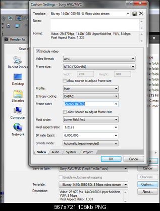

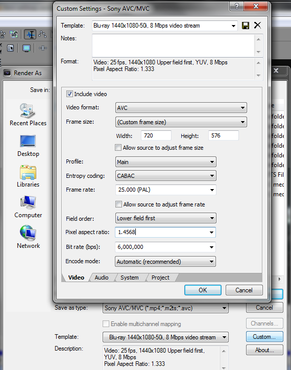

    H264 is more difficult to edit and for hand held interlace camera video, you won't get that much more compression performance vs. MPeg2. VBR will introduce editing issues. If these tapes are other than locked down camera talking heads, then interlace should be preserved through editing.
    MPeg2 in DVD format is a safe way to go*. The Sony AVC (h.264) codec can be tested as an alternate. Start with Blu-ray 1080i then modify settings for SD. Here's a start point. You may need to upgrade all the field versions of Vegas to edit h.264.
    Starting point for SD PAL AVC (assuming 16:9 wide)
