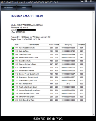

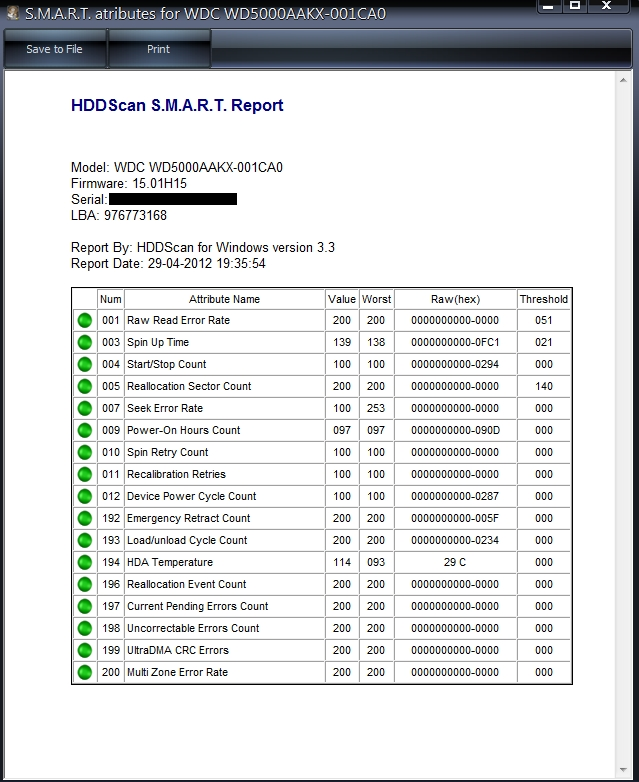

  3. Can you post screenshot SMART from HDDScan?
    but remove serial from screenshot:
