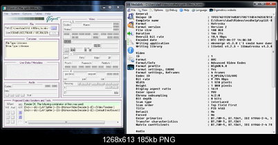

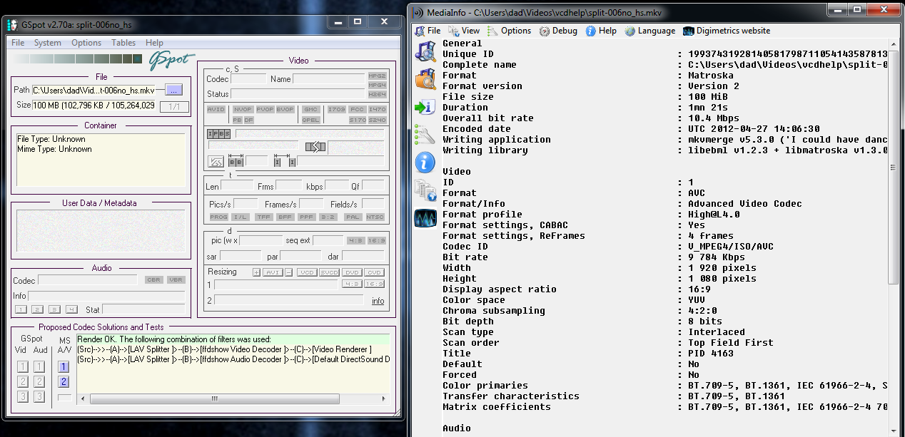

  9. aBigMeanie aedipuss's Avatar
    Oct 2005
    666th portal
    The DSS() issue may be a matter of what MKV reader/splitter you have installed. I used LAV Filters.
    it's not the lav splitter that is the difference between you and us not getting correct info. what else is in your chain?
  10. Lav -> CoreAVC
    I just disabled CoreAVC and used ffdshow. That worked fine for me too.
