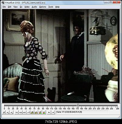

    By ghoting, I mean.... Frame 171... but there are lot more not clearly visible.
    Ghosting Effect in DeInterlacing
    Following is the result of proper deInterlacing (used jagabo's script) maintain same frame size as PAL.
    DeInterlaced
    Result : Ghosting persist because of improperly encoded source video.

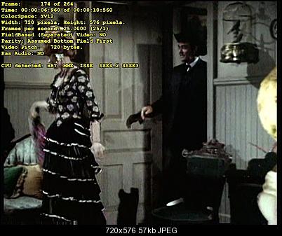

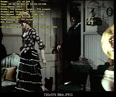

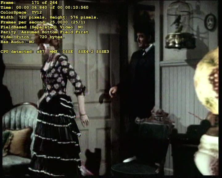

  10. I'm seeing no residual interlaced frames after my script. Frame 171:
    But there are missing frames and duplicate frames. For example, between frames 12 and 13 there is a missing frame. Between frames 124 and 125 there are six missing frames (I think the film bounce distortion caused this). And frames 130 and 131 are duplicates. Different methods of decimation may work better. For example, I found that trimming away 16 frames after Yadif fixed most of the above problems.

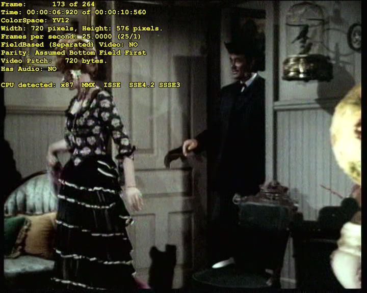

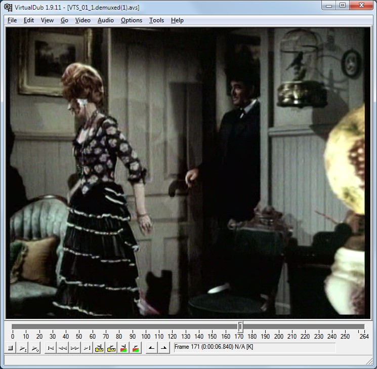

  11. It seems like your VD frame 171 is frame 169 for me in AVIDemux so check frame 173.
    I will check later on this week on Windows, at this moment I do not have access to Win machine to check this one out.
    My output is also same as yours using your script. Only difference in frame number, mine is 169, seems AVIDemux removed initial 2 frames or whatever. But, total difference is 5 frames in short clip.
    Proper DeInterlacing using jagabo's script.

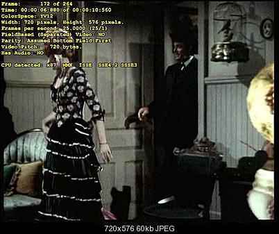

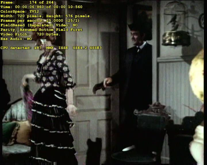

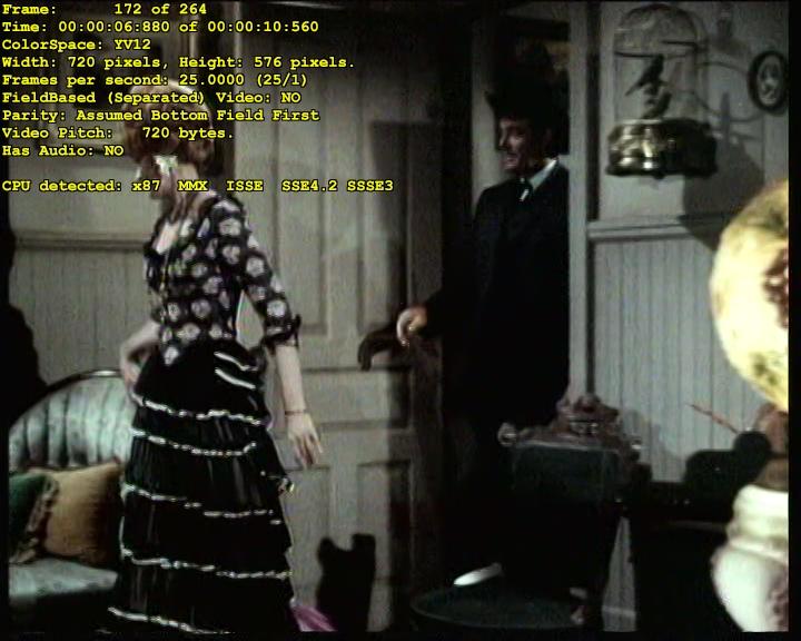

  12. Frame 173 has no comb artifacts either. Like I said, I see absolutely no comb artifacts or ghosting after my script.
