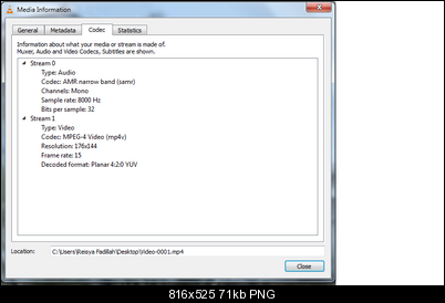

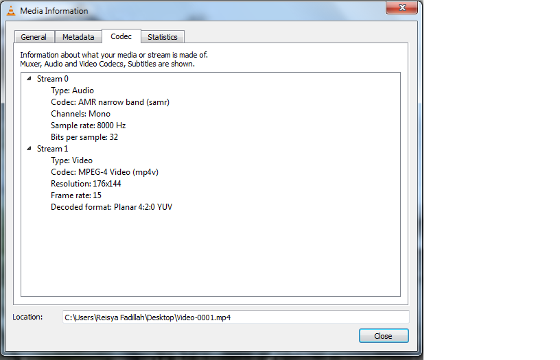

  12. here the sample video from my file
    and the information about the videoClick image for larger version
  13. hope this give the information about how the video can be played on my file,thanks in advanced

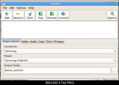

  17. Member bat999's Avatar
    Feb 2008
    Originally Posted by rebbeca View Post
    yes it does work,what converted did u used??
    Hi
    I used WinFF from here ---> http://winff.org/html_new/
    With a new preset, it's in the attachment below.
    And read the instructions "How to import a preset" here ---> http://code.google.com/p/winff/wiki/Presets

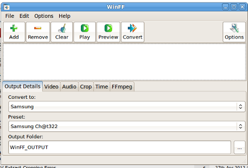

  22. Member bat999's Avatar
    Feb 2008
    Another sample attached below.
  23. your 2nd sample was able to play @ my phone,how do u do it,am i doing wrong in setting,please help me,thanks
  24. Member bat999's Avatar
    Feb 2008
    ... am i doing wrong in setting
    Hi
    Look again at post #17 above.
    Or use a different program.
