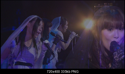

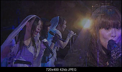

    Here is an image quality example comparing smoothdeinterlace vs. QTGMC - you can see the jaggie aliasing artifacts produced by smoothdeinterlace
    AssumeTFF
    SmoothDeinterlace(doublerate=true)
Name:	20 SmoothDeinterlace.png
    AssumeTFF
    QTGMC(preset="faster", sharpness=0.75)
Name:	20 QTGMC.png

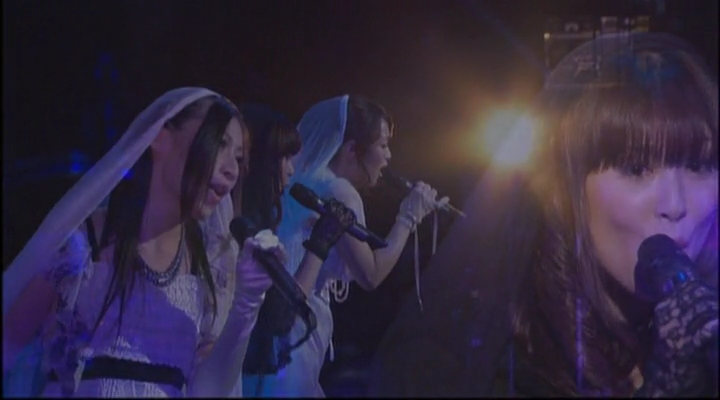

  8. wow that's definitely better....thanks a lot!

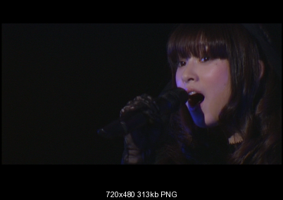

    however my main issue still remains, let me post another clip where you can see it properly
    this is what I see when playing avs:

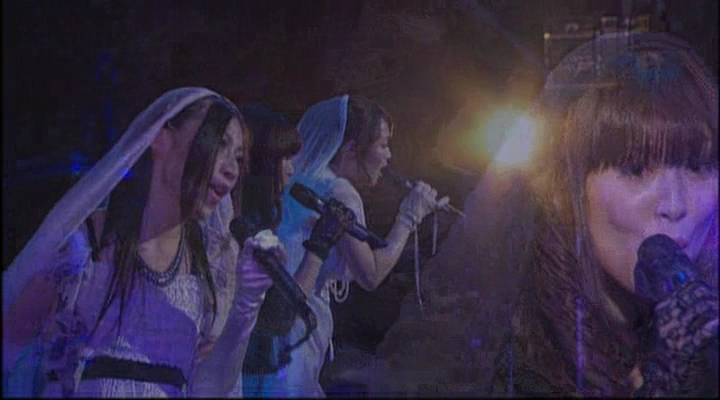

    this is what I see when playing encode in MPC HC (however windows media player does a better job on covering it up)
    it's all over the image, but best noticed about the area with the light. And it just disappears at 5th sec
    same source, encode below

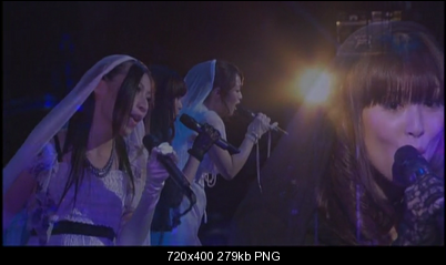

  9. It's not apparent in your encode.
    This is from your encode , same frame 189, sample1.mkv
    Perhaps it's a playback configuration issue,? What renderer and decoder are you using? Do you have graphics card and monitor calibrated ?
    For example if you are using VMR9 or 7 renderless, the levels will be elevated and you will see noise that you shouldn't normally see

  12. I replicated what something close to what you are seeing in MPCHC by choosing "skip deblocking always" in ffdshow (configuring ffdshow to be the h264/avc decoder) . (The other difference might be you took screenshot in jpg, I took it in png (lossless) ) . I believe it's a playback configuration issue, either decoder or renderer
Name:	deblocking disabled.png
