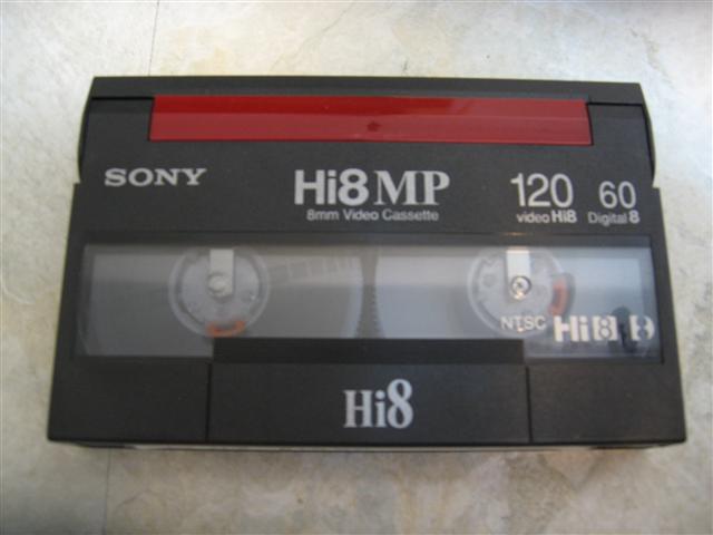

    The first recording was recorded on a Sony Hi8 MPClick image for larger version
ID:	12149, it played back very well in the camcorder (and TV via a/v cables,) sound and all. But on Sunday they gave me a different type of tape.

    both those tapes you show are hi8 metal particle. the xr in one is just marketing hype as any hi8 tape could be used in a xr cam.
