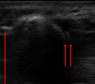

    I have an ultrasound device which produces digital video of 35-50 hz. This is streamed through a S-VHS port on the device onto a computer, where the resulting 25 hz stream is synchronized with other data.
    Some of the frames in the resulting video have artefacts that look a lot like interlacing, but do not cover the whole height of the frame. Here is a screenshot of part of one such frame, red marks are added by me.
    This happens only in some frames, and in different amounts. Sometimes it's the whole frame, sometimes the bottom 50%, sometimes 10%, etc.
    I am not a video expert, but this reminds me of what I see when I take a photo of my TV screen: The screen is in the process of loading the next frame. Personally I wouldn't expect a streaming signal to behave in the same way as a display signal, but what do I know...
    My questions for someone more expert: What causes these artefacts (which part of the setup, etc)? Is this to be expected for a setup like the one I mentioned? Is there anything I can do to prevent this?

    But it does look like tearing (part of the displayed frame from one source frame, part from another) along with interlaced video like you describe, either during capture or during playback. If the ultrasound device is creating frame rates that vary from 35 to 50 Hz then you probably will have tearing problems since the s-video output has to be 50 fields per second which are then packaged as 25 frames per second (for PAL capture devices).

  4. It looks like the device is switching frame buffer in the middle of putting out fields (probably whenever a new field/frame has been collected) so you get tearing in the middle of a field. This is why some frames appear progressive, some interlaced, and some a mixture of the two. Even if you deinterlace you will be left with some torn frames.
    Your interlaced video is bottom field first. Both the deinterlaced samples have been deinterlaced with the wrong field order. That is why you get that fast jerky motion. I don't know why the program you used didn't deinterlace one of them properly. Attached is an Xvid AVI that was deinterlaced using VirtualDub's deinterlace filter in Yadif mode, double frame rate, bottom field first. If you step through frame by frame you'll see torn frames.

    Thank you. Do you think that it is the ultrasound device that is doing an unsatisfactory job here (switching frame buffer)? Or could it be a problem of the DV card in the computer?
    It's the ultrasound device.
