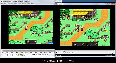

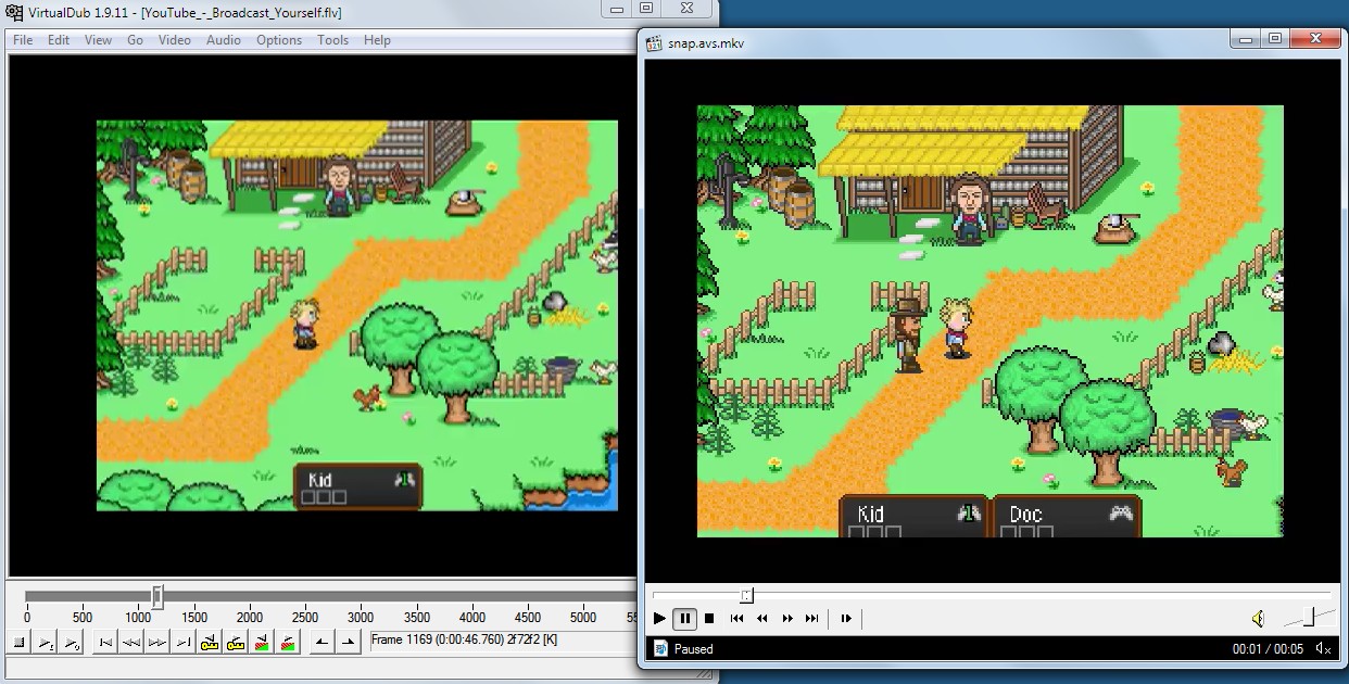

  4. The screen shot shows a 540x400 image in a slightly larger frame. I downloaded the 640x480 Youtube video and and found a similar shot. It had a 480x360 image in the 640x480 frame. Downsizing the 540x400 screen shot to 480x360 yielded approximately the same image quality as the youtube video. If you're going to use a 640x480 frame why not leave the video 540x400 and just pad out the borders? That way you can avoid any resizing. The Youtube video and your screen cap encoded with x264 as indicated:
