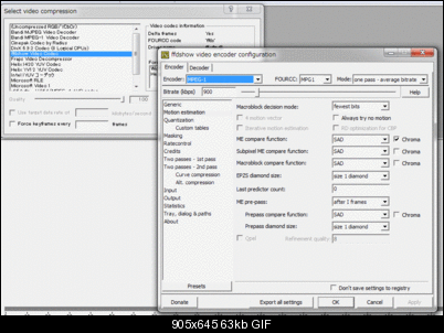

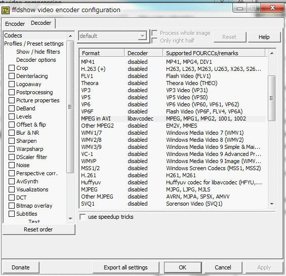

  1. I DID pick Pick ffdshow! and as i said i chose the same settings as jagabo. Anyway, this is a part of the video im trying to cut. The part i want to take out is the one with the human actresses and leave only the cartoon but no matter what i do, i just cant cut it off.Are you sure there isnt another program there that can just cut the video right and save as direct stream copy?

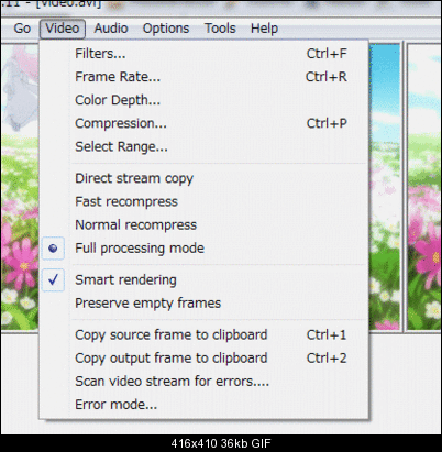

    You also have to use AviFrate, to fix framerate, as jagabo also said.
    And don't check DirectStreamCopy at Video menu. Use FullProcessingMode.
    And turn on SmartRender, of course.
    Hope it helps.

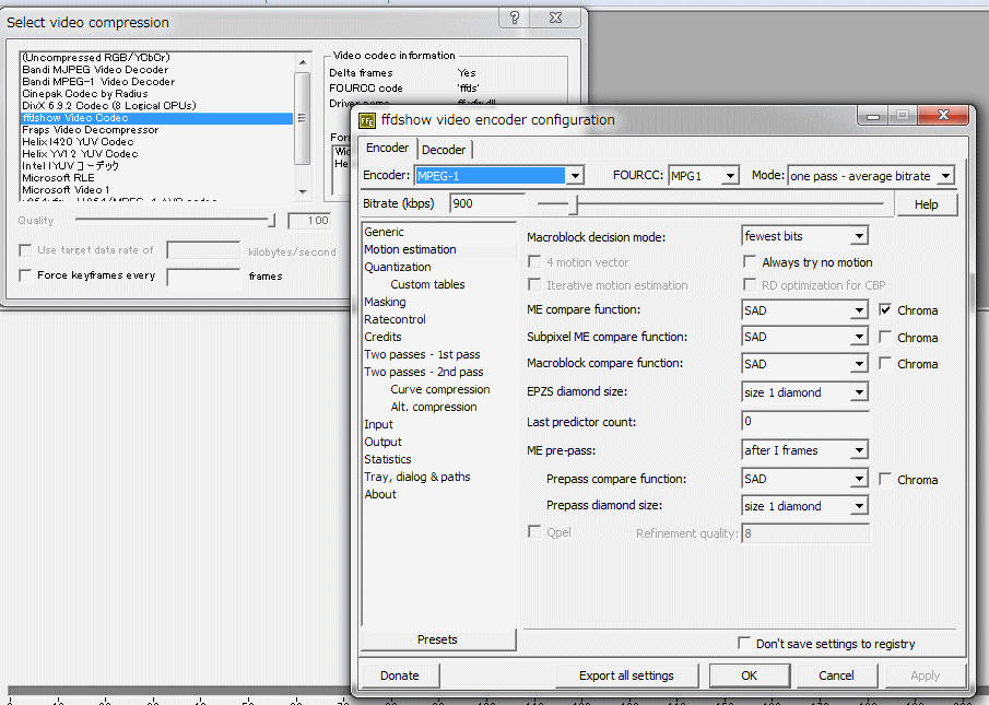

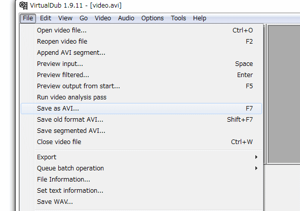

  3. Well, i dont get it. Im doing exactly as you say. Here is the proof:
    Can you tell me where am i wrong?
    Thanks.

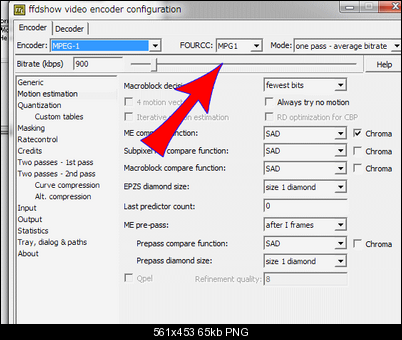

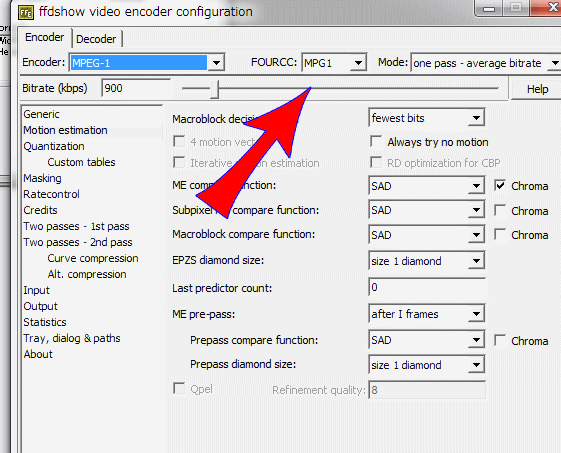

  4. I'm not sure, but there is a little thing with your settings that can be the guilty.
    Change to MPG (not MPG1) and try again.
    Good luck.

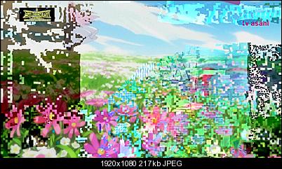

  15. Originally Posted by dfisher052 View Post
    Avidemux 2.5. I'm really surprised no one has mentioned this. It does just what you asked and it works. I use it all the time for just exactly what you asked "cut video and save as direct stream copy".

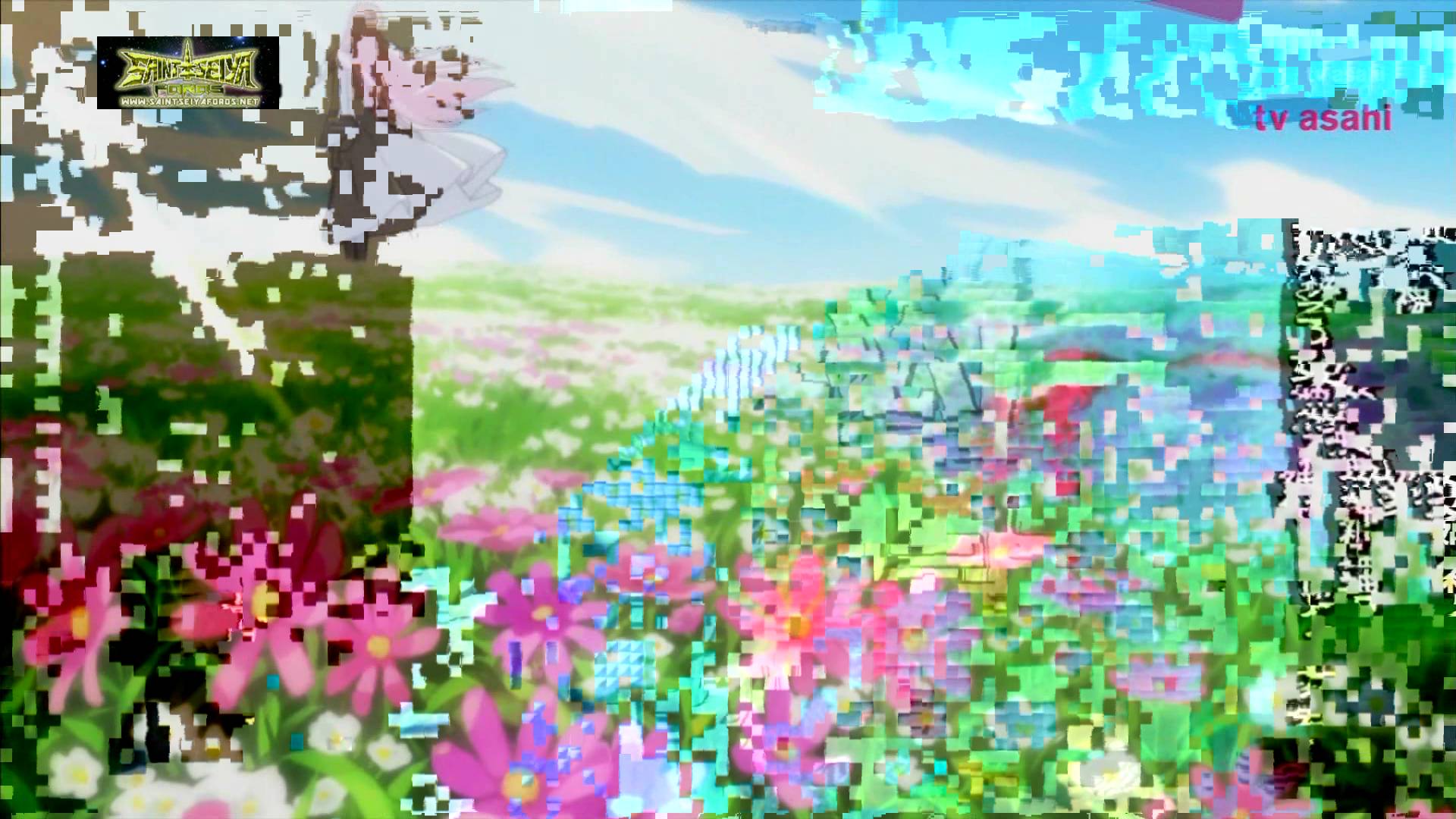

    Comparing both Avidemux x Vdub at cutting point:
    Avidemux
    Vdub
    Make your choice.
    Thank you.
