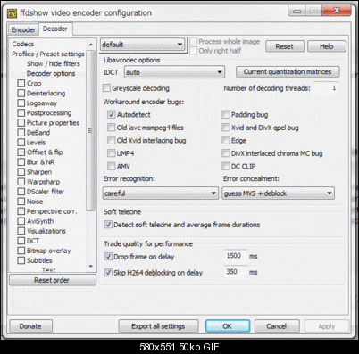

  18. Hi,
    i opened the program and went to the decoder tab, then decoder options but i cant find were to enable mpeg in avi.
ID:	12153where is it on the screen?
    Thank you.

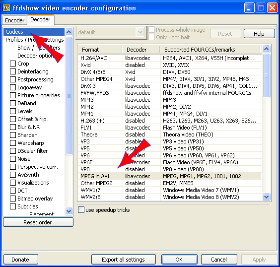

  19. Originally Posted by supercain View Post
    You are on "Decoder options". Click on "Codecs".

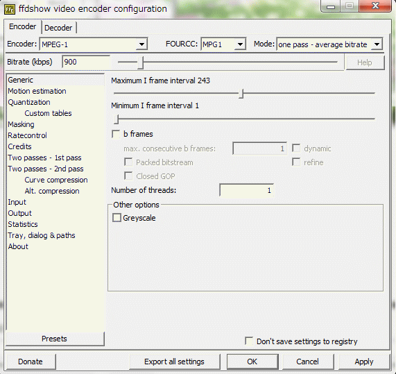

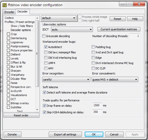

  22. Right now i have it like this
    but i still get an error.. By the way, im choosing full processing mode. Should i choose something else?
    Thank you.
  23. The sample clip I downloaded from bandicam.com had the frame rate set as 30000000 / 1000000. That was probably causing a numeric overflow in VirtualDub or ffdshow's frame rate calculations. I used AviFrate to change it to 30000 / 1000 to eliminate that problem.
    What's the frame size of the video you're working with? Maybe ffdshow has different frame size limitations. Stick with mod 16 whenever possible.
    Yes, you should be using Full Processing mode and Smart Rendering.

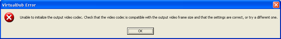

  29. Originally Posted by supercain View Post
    Unable to initialize the output video codec. Check that the video codec is compatible with the output video frame size and that the settings are correct or try a different one.
    Like this?
    It's because you are doing exactly what was said not to do. Pick another encoder, not BandMJPEG or other "decoder only" codec. Pick ffdshow (inside Vdub video compression window) and set it to MPEG1 as encoder (clicking Configure at the referred window).
    As jagabo already said at #21.
    Thank you.
