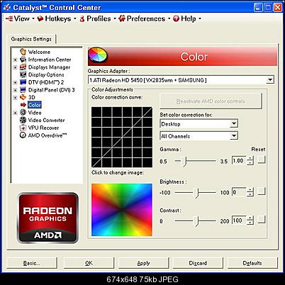

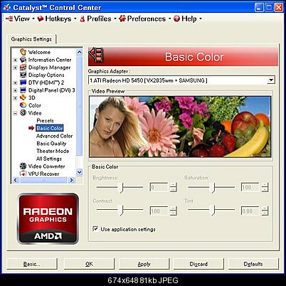

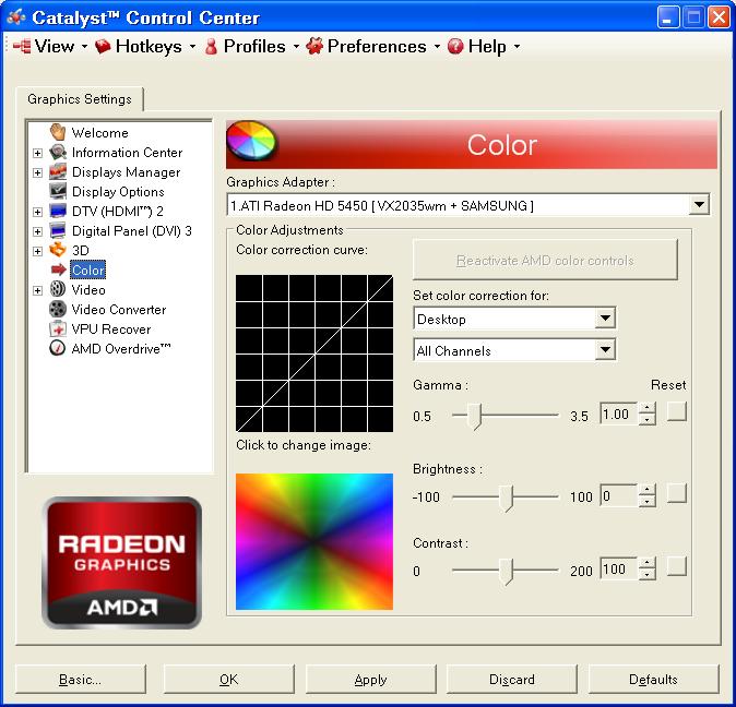

  10. Could you please tell me where I'm supposed to go to change the vdieo proc amp setting as I'm confused. Do I do it in Catalyst Contro Centre?
  11. Originally Posted by holygamer View Post
    Yes, in CCC. Avspmod appears to use a rec.601 matrix to convert YUV video to RGB for display (at least for standard definition sources). You want to adjust your graphics cards video proc amp so that it looks the same.
    Actually, what you want to do first is adjust your monitor with an RGB bitmap and make sure you can differentiate almost all of the 256 gray levels (most monitors will have a little trouble with the darkest shades). Then adjust the video proc amp so that video appears correctly on the display. As per the link I gave earlier.
  12. I've got VideoRedo open and AvsPmod open side by side. The finished video in VideoRedo looks brighter than the original video in AvsPmod. So in CCC I changed the contrast in the Video setting but that doesn't change the contrast in AvsPmod or VideoRedo it justs changes it for videos playing in Windows Media Player.
    The Desktop Properties section just changes the contrast for everything. How do I change the contrast for just VideoRedo or AvsPmod?
