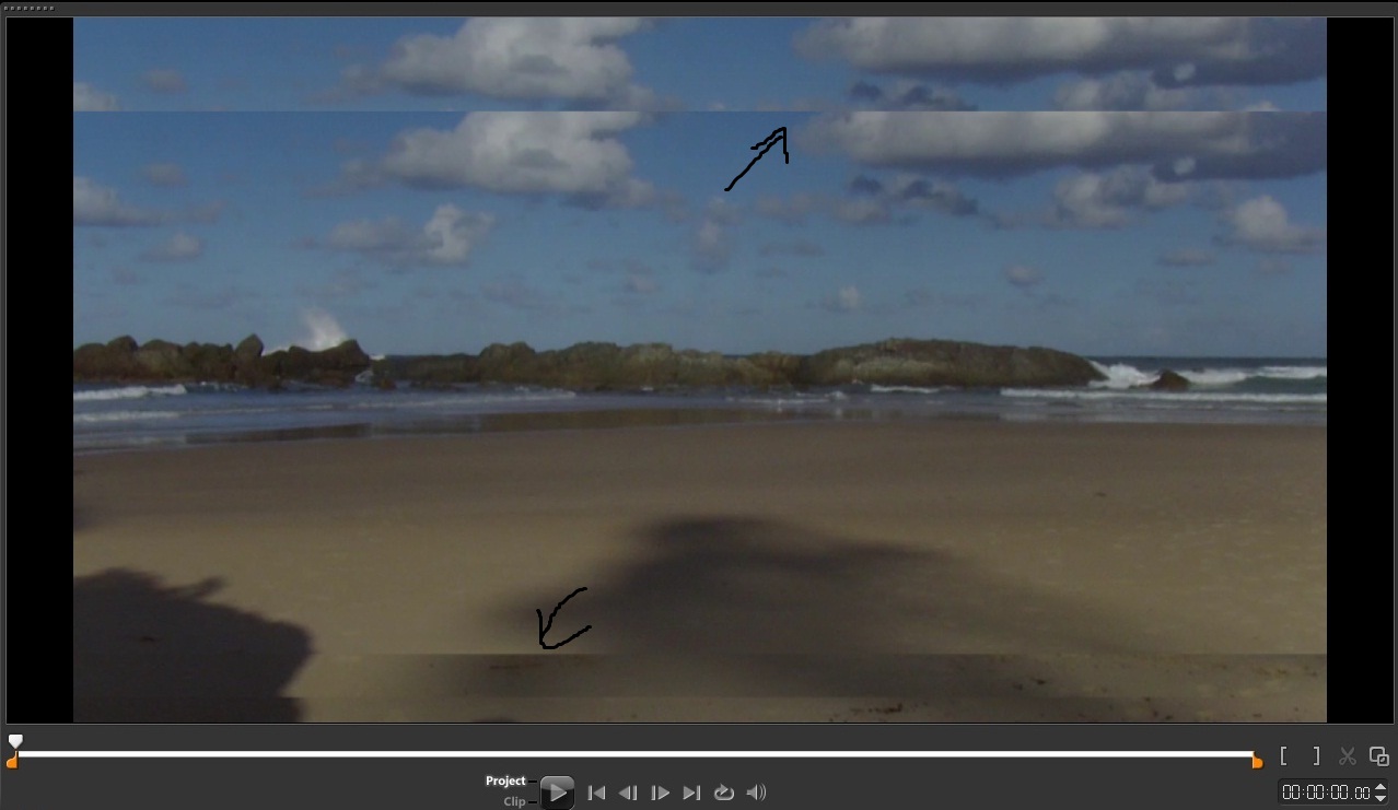

    I'm the happy owner of the new Corel VideoStudio Pro X5 program. I've resently put together my first video, but then an error occured.
    In the preview window i noticed that everytime a new clip is beeing played, the program adds a top line and bottom line, often displaying something from the previous clip in the timeline. I thought this was not a big deal, but then after saving my video as a finish .avi file, the problem was not solved..
    I've attached a screen picture of my problem.
    Anyone who can tell me what's wrong?

    Maybe that's a new feature? "Reflecting Endcaps".

    I've now been searching around in the program and I wasn't able to find any settings or changes regarding "Reflecting Endcaps".
    Is there other words for the same thing or?
    Sometimes the program adds an icon saying "DivX" ind the bottom right corner. And it's only there for about 3-4 secs

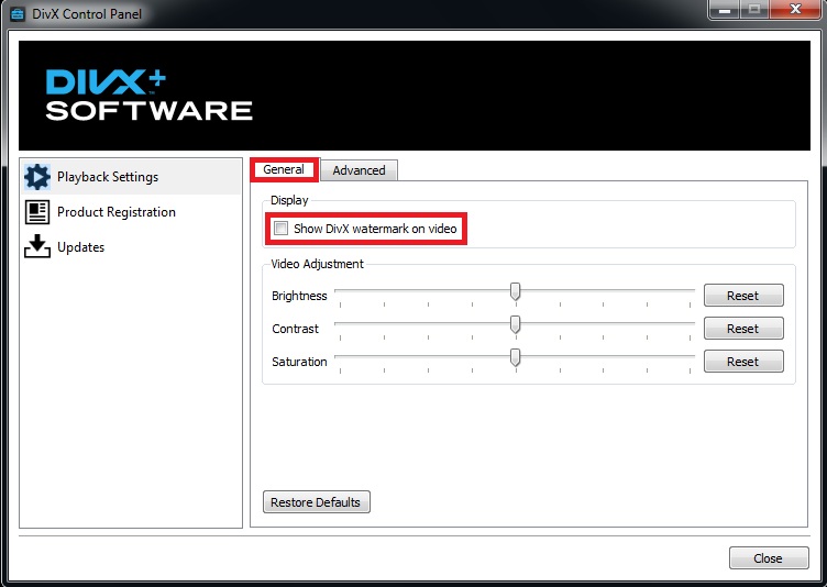

    Its a normal. Go to DIVX config and uncheck this (show divx watermark).

    Just a thought - measure the distance between the lines and the width of the picture and see if it comes close to 16:9. Maybe your project is set to 16:9 and the source material is 4:3 and there is some weird built in app to simulate 16:9 a bit like TV stations in Australia when they are showing a 4:3 clip add fuzzy repeats of of part of the frame either side. In you case it is top and bottom?

    Cauptain: Where do you find the "DivX control panel" ??

    - Start, All Programs, Divx Plus

    It was so simple! By unticking that "Show DivX Watermark On Video" box, the problem was solved
