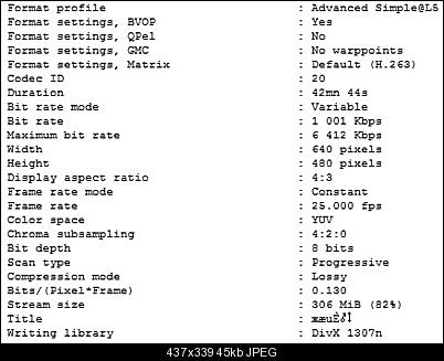

    See below the MedInfo capture TITLE
    mp4box always generate that trash for the title if i do not specify one.
    How do I disable that?
  7. That's a bug in MediaInfo, not mp4box.
    it might work to add an empty track name as workaround:
    name=Val specifies the name to give to the media track.
    source: http://gpac.wp.mines-telecom.fr/mp4box/mp4box-documentation/
    -> just tested,... it does help, seems like MediaInfo assumes that there has to be a Title entry,.. and takes whatever it suspects to be one,..
