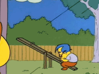

  7. Every frame is the same and it's just a simple anime clip. Pretend like a particular scene but someone decide to go loco and throw the focus all over the place. No cameras or any angle at all. I want to eliminate the panning motion of the camera and have it focus entirely on the scene.
    Here's a example:
    https://forum.videohelp.com/images/imgfiles/gallery/zD3eR
    Imagine if the person made the focus entirely on the sky at first and then slowly pans down towards the middle(can't see the sky or the ground anymore except Milhouse) and then eventually to the ground. Is like trying to fit a image back together, even though it was a whole one piece at the start but segregated into different views.

  12. If the background is static it's not impossible to do what you want. As I understand it, you have something like this:

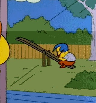

    And you want to change it so the frame no longer pans down. You can use the first frame to create the missing top part of the rest of the frames, and the last frame to create the missing bottom part of the earlier frames. Then you have to coordinate the motion of the animated clip over the background.
    First construct a background from the first and last frames. I've darkened the last frame here so it's obvious what I did:
    Then you overlay the original animation onto that background and add motion tracking to undo the panning.

  13. Nice, I was in the middle of making exactly what you just did and you beat me to it. That's exactly the problem and what I'm trying to resolve. Now I just need some guidance on Sony Vegas how to pull this off, my friend knows about as much as I do :/
  14. Originally Posted by Oldspeak View Post
    If jagabo's gif is exactly simulating your problem , there is no pan or vertical tilt. The camera itself is moving vertically downward. This causes the picture to look like it's moving upwards. ie. it's a "pedestal shot".
    Vegas doesn't have a motion tracker, so you would have to manually position each frame using keyframes. With a motion tracker , it would apply the opposite movement. e.g. if a frame moves 10 pixels vertically up in relationship to the previous frame, you move it down 10 pixels. So you would be left with a 10pixel black border at the top - that is why you "borrow" information from other frames as illustrated in jagabo's example, to fill in the black borders
    A strict pedestal shot doesn't contain additional horizontal information in adjacent frames - you cannot reuse horizontal data, so a zoom out, or wider field of view is out of the question . If this is what you wanted to do, you would have to reconstruct the horizontal edges from other material.
