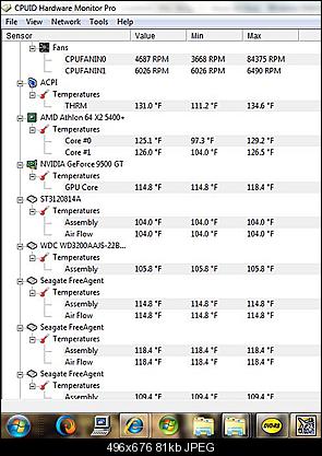

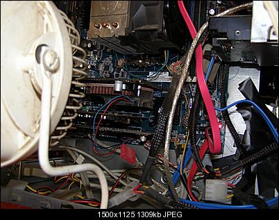

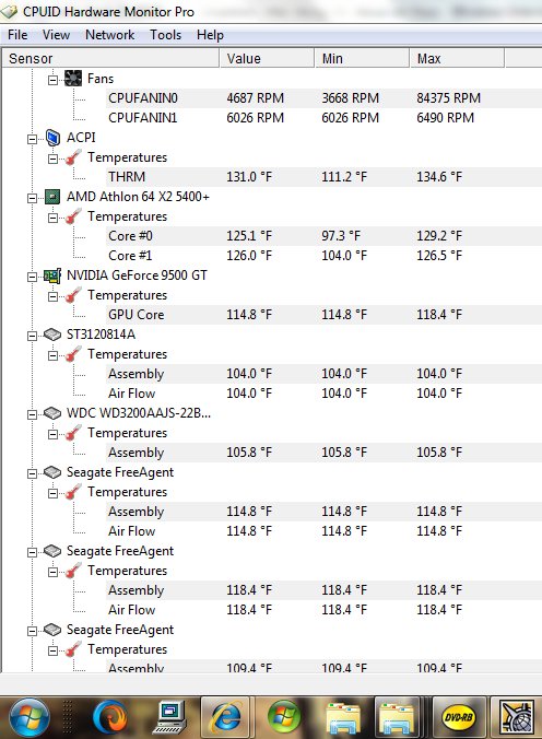

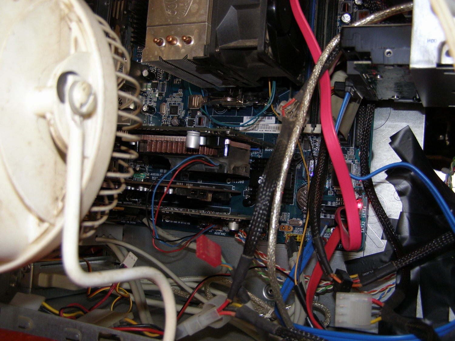

    Okay with the fan on my work table ... blowing on the video card ... here are the specs now ... if you look closely ... you can see the small fan glued to my video card ... I use silicone rubber cement glue ... works great. That table fan works great too ... blows air directly at what it's aimed at. Check the video card temps ... the temp dropped quite a lot ... with the air blowing on it. Oh and it's 90 degrees in here ... temps from other post ... hours ago ... it was 3 AM in the morning.
