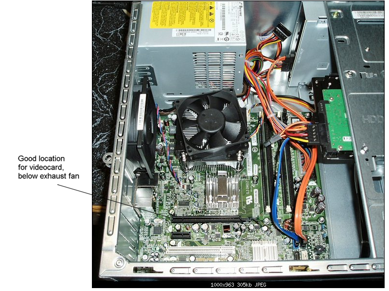

    Here's the odd thing. I put my old video card into the kids' HTPC, a Dell Vostro 200 dual core (it is a bit roomier in there), and it works fine. Go figure.

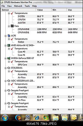

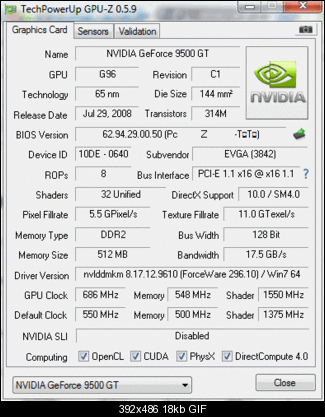

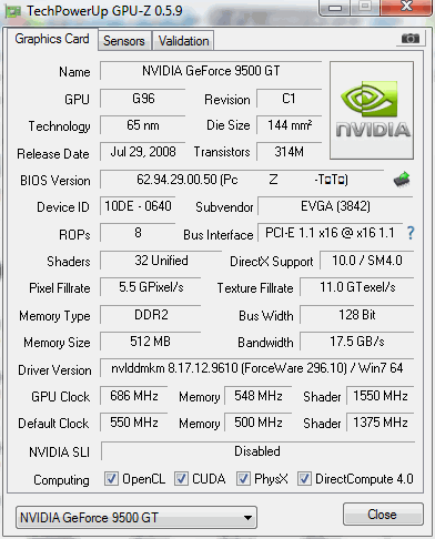

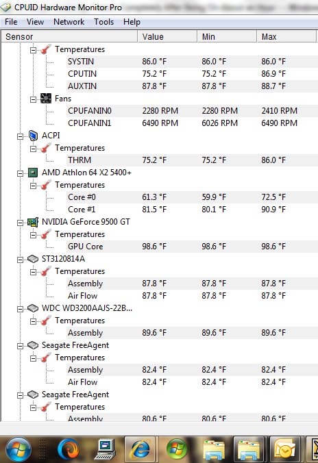

    I use CPU-Z ... GPU-Z.0.5.9 and ... Hardware Monitor Pro 1.08
    Here is how my system is behaving right now at 3AM ... April 20 2012
    The fan spinning at 6K is a little 50MM fan glued to my video card ... the fan inside my 9500GT just didn't make me happy ... now ... I'm happy
    I do run my Nvidia 9500GT video card ... overclocked sometimes ... especially if playing games like Crysis 2. The Nvidia Perfomance feature wont detect the overclocking limits within WIN 7 but it will in WIN XP ... so I use the settings it recommends in WIN XP and do a manual overclock in WIN 7.
Name:	GPU-Z Screenshot.gif
Name:	AN-M2 specs.jpg

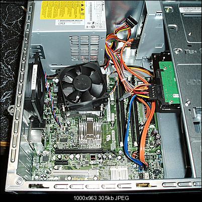

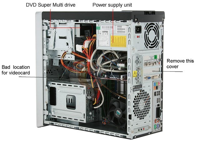

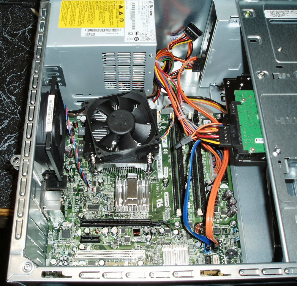

  24. After looking at your cases the problem is definately overheating. Buying another videocard won't solve the problem, buying a new case will. At the very least remove the PCI card and cover above it, it should allow enough cool air to enter.
Name:	bad design.png
Name:	bad design.jpg

    The PCI card above the video card is a small card for the built-in internal wireless n, and as you can see, above that is the Hauppauge TV card. I can't really remove those. The new power supply I put in a couple of weeks ago not only provides more juice (500w compared to the OEM 350w), but it has a sleeve bearing 120mm fan, moving much more air than its predecessor.
    I just tried out a GPU Meter Gadget,
    and it shows a pretty steady 53° to 56° C, similar to the example. In other words, as Majel Barrett says...

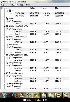

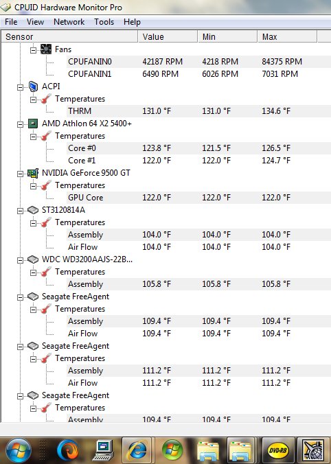

    It's Saturday and it's 5:20 PM and very warm today ... somewhere in the 90s
    here is what my PC is doing now ... in my garage ... it's very warm in here ... I wearing shorts and no shirt. Looking at the spin speed of the CPU fan ... whoa !! ... no it is not spinning that fast ... it's actually around ... 4400 RPM ... 4 pin 90mm fan
    DVD Rebuilder is running in the background and CPU is getting nice and warm.
Name:	Monitor screenshot.jpg
ID:	12092Name:  Desktop gadget.jpg
