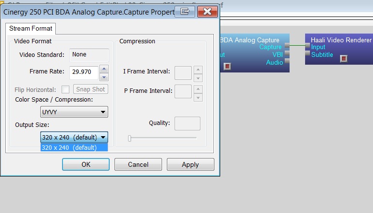

  18. I don't know for you guys but i'm stuck with 320x240 / 29.9 fps / UYVY on win7 x64 it's a drivers limitations i presume these are the only ones working unfortunately.
    https://forum.videohelp.com/attachment.php?attachmentid=12166&stc=1&d=1335367273
    You can make the test with graphedit ( or graphedit plus in my case)
    Unlike on XP:
    http://imageshack.us/photo/my-images/684/44190441.jpg/

  21. master you can do custom res in windows 7 and don't enter crossbar or capture pin after that it will revert back in windows 7 is pain in the a.. i sold my pinnacle 110i it had same problem in windows 7 no levels ( proc amp also) i use different card now and it is ok
  22. What i meant to say is that it's probably why Asesinato is stuck with 29.9 fps / 320x240...drivers fault
    He should check with graphedit but if he is stubborn not my problem....
