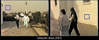

    Asesinato, I don't know if you have recaptured the scene shown below. It has shots that will make better noise samples. NeatVideo works best with noise from large clear areas like the open sky and the smooth areas of the side of the church shown in the sequence below. I took these images from your earlier "1.ts" post. It wasn't a good capture and has NO DETAIL. If you have recaptured this scene using the same process you used for the 3 captures posted above, is it possible to post a few frames from the original unfiltered AVI? The blue square in the images shows the kind of open areas that NeatVideo uses best. The shots from the old "ts" captures can't be used.

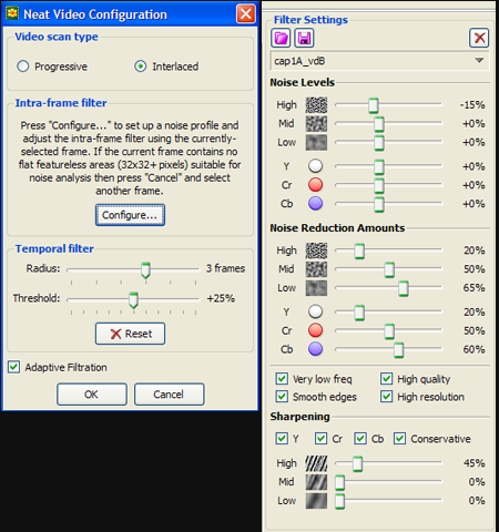

    Havent try the script... Had neat in mind but dosnt it remove alot of details also?
    It does if you don't learn how to use it -- just as with any complex denoiser, whether in VirtualDub or Avisynth. If you want to see detail do a fast disappearing act, try AVisynth's FFT3D filter at strong default settings. With NeatVideo, never use the defaults.
