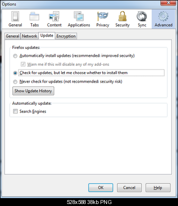

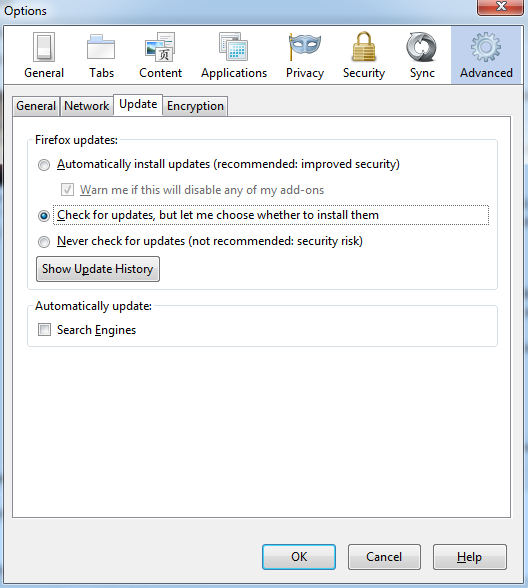

    use the update setting in the pic below. it's what i use and when you start firefox it will notify you if an update is available and you can choose to install or not.
