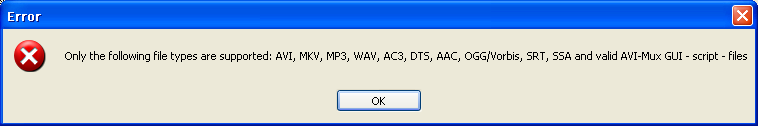

  17. Originally Posted by jairovital View Post
    I'll give a try to avimuxgui.
    Look:
    Input file is AVI container:
    General

    Editet:
    Sorry. Format is mp4 container. My mistake.
    Thank you.
  18. Originally Posted by jairovital View Post
    virtualdubmod had done the job, but because it couldn't read H264 natively, I opened it using DirectShowSource and had to encode again... (bad deal).
    It works for me. Use it in Video -> Direct Stream Copy mode and it shouldn't matter if you have a VFW h.264 decoder installed or not.
  19. avimuxgui pointed my mistake!
    Explaining, for future references and searches:
    If I create a video stream H264 in AVI container, Avidemux can produces a good dual audio AVI.
    If I create a video stream H264 in MP4 container, Avidemux cannot produces a good dual audio AVI.
    Now it's fine. I have a dual audio AVI with H264 video within.
    Thx, guys.
