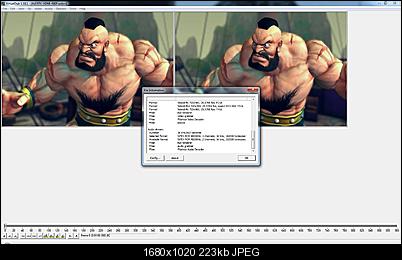

  9. Lone soldier Cauptain's Avatar
    Jan 2006
    Brazil
    Strange, because my virtualdub 1.10.1 open Webm default using FFDSHOW.
    Claudio

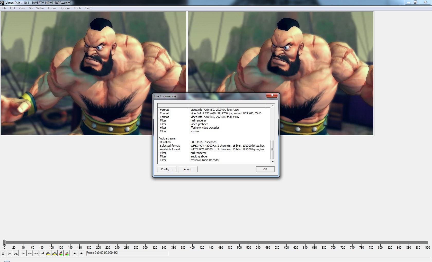

  21. Member racer-x's Avatar
    Mar 2003
    3rd Rock from the Sun
    You can also open .webm files in Virtualdub via the FFMPEG import plugin.

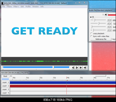

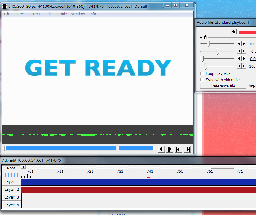

  23. Originally Posted by racer-x View Post
    Thanks for the info, that means AviUtl should be able to handle WebM also:
    Actually it is the Libav that handles the import (ffmpeg incorporate Libav sources anyway)
    However, seeking is somewhat slow and jerky
