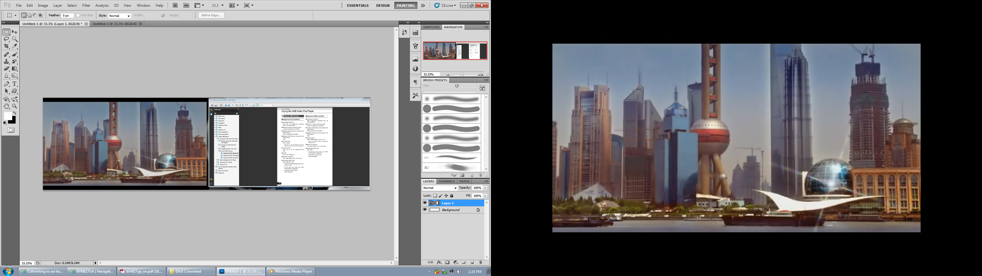

    before image, top, is played in VLC H264 MPEG 4 AVC 640x328 as you can see it has just a little letterbox ex
    after image,bottom, is played in WMP, this time on the right of image, and is 640x480, cant get the codec info, but as you can see it is a lot smaller on the screen.
    My guess is the software you used put the 16:9 source into a 4:3 (640x480) frame by letterboxing it. Then the player, seeing a 4:3 video, pillarboxed it on the 16:9 display.

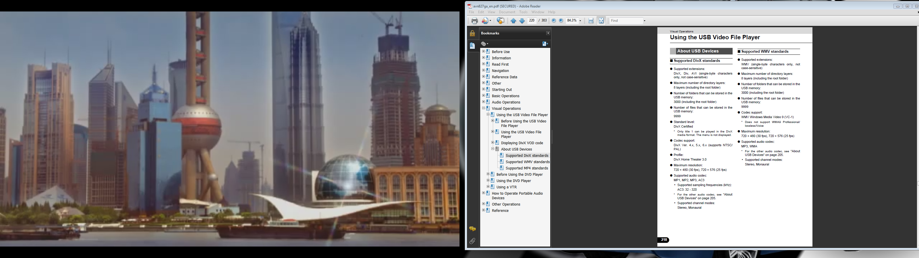

    Jagabo thanks that worked as did the plain avi 16:9 720x576. As before, if anything, just a little short on the width meaning it did not go to the edges of the screen.
    I know if I download a vid that is say 4:3 format it will not fit the screen and I don’t want it to stretch out to fit but the problem I am having is that some when converted to avi divx 720x576 only play in a small box, refer to image 2 in above post, and does not fill the screen. I have just tried wma 720x400 and its looks the best so far.
    I have added some clips of videos playing in the unit itself, I know they are dark, but the image shows how they don’t reach the side of the screen. In the first clip, P1000909 the guy dancing, the original video before conversion is MPEG 4 1920x1060 but when converted does not fill the whole screen and depending on how I convert sometimes is just a small box. It is now a wma 700x 400.
    The second clip, P1000910, in its original form before conversion H264 MPEG 4 640x328 and you can see after conversion fills the screen. So this is why I am so confused... that the first one in original form is twice the res but will not fill the screen after conversion but the smaller one will. Oh and the mime still the original video is 1280x720 and it too will not reach the edge of screen.

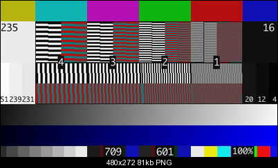

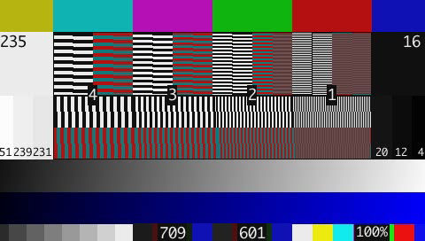

    Attached is a 480x272 Divx AVI file. See if your player plays it pixel-for-pixel. It should look like this:
    Closely examine the black and white lines in the "1" area. You should be able to see each individual line.
