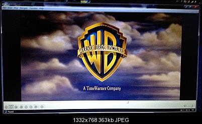

    I've got a movie (Format : AVI,Codec : XviD with AC3 audio,Resolution : 1280x544) and i want to resize it to 1280x720,i do and i try different aspect ratios (16:9 PAL,16:9 NTSC,4:3 PAL,4:3 NTSC,...) but everytime i get problem.
    file gets converted but the resolution is not what i wanted.
    look at the image i post:
Name:	IMG_0054 - 2.jpg
    you see the black bars in the left and right side of the player?
    how can i fix it???
    Please HELP!
    I use VirtualDubMOD.
  2. Member Cornucopia's Avatar
    1280x544 doesn't say anywhere what DAR it was originally or what it was supposed to be. IF the original DAR was SUPPOSED to be 4:3, then of course you SHOULD be getting pillarbox bars upon fullscreen playback to a 16:9 TV.
  3. 1280x544 is same thing as 1280x720, for 2.35:1 AR content. Just letterboxing is cropped
    To convert it back, add the borders back (720-544)/2 = 88pixels to top and bottom each
    So the black bars will be on the top & bottom instead (letterboxed)
  4. If you're intending to make it 1280x720 you want to add black bars above and below (like, maybe, 88 both above and below). This looks to me like you added them to the sides. Or set some screwy aspect ratio(4:3) when you shouldn't set any at all.
    Why can't you just leave it at 1280x544 and let the player add the bars? What are you using to play it to the TV?
  5. Thanx to everyone for attention.
  6. Originally Posted by manono View Post
    it gets to small when i want to watch the movie in a 42" LCD TV.
  7. How can i make it fullscreen in 1280x720?
    the black borders are really annoying!
  8. Originally Posted by poisondeathray View Post
    Would you please explain it a little bit more?
    how can i do it in VirtualDubMOD?
    i used "Uncrop to:" function in "uncropMKV" but it didn't work again.
