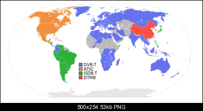

    Originally Posted by Goodluck Jonathan View Post

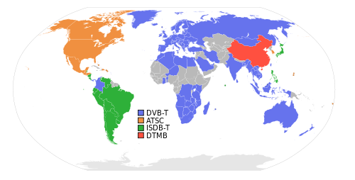

    "Many US videophiles complained about ATSC..." is that so? I have not watched TV in the U.S. since the late 1980's and my info is second-hand (brother in California) but I remember the horrible quality of Never Twice The same Color. I thought the format had gotten a major overhaul lately.
    ATSC was implemented for over the air digital broadcast in the USA back in the late 1990s with full implementation in 2009 when analog NTSC broadcast was eliminated.
    ATSC (with 8-VSB modulation) fits the US/Canada/Mexico broadcast model where one high power transmitter feeds large geographic areas (limited by earth curvature or terrain). Smaller countries have opted for DVB-T (COFDM modulation) where a higher number of lower powered transmitters are used to contain broadcast to local borders. Japan has implemented ISDB-T to replace analog NTSC and the older HiVision HD system. ISDB-T is similar to DVB but with features optimal to former NTSC regions. Most of South America has adopted the Japanese ISDB-T standard for digital broadcast.
    2012 is the year when the ATSC Version 2.0 standard is finalized. This revision will update features and codecs to similar levels now in DVB-T and ISDB-T. A new tuner will be required to access the new features.
    https://forum.videohelp.com/threads/340097-Discuss-advanced-ATSC-broadcasting
    So in summary, the differences between systems are not so much about picture quality or features, but more about transmission methods and political boundaries.
