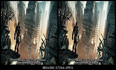

    The use of the /n switch will be problematic where long subtitle strings will need to be split.
    Example:
    His interest was in the balance and harmony of nature.
    What it will need to become for sbs, <> indicates space adjustment
    His interest was in the balance<>His interest was in the balance\N<>and harmony of nature.<>and harmony of nature.
    Result:
Name:	Sbs subtitle example.jpg
    It will be a matter of getting the spacing correct, thou this will still not be 3D because there is no Zdepth unless the tv supports some form of function when set in 3D mode when given 2D source.
    Cornucopia has covered the rest.

  30. Originally Posted by Bjs View Post
    Example:
    Result:
    [Attachment 12152 - Click to enlarge]

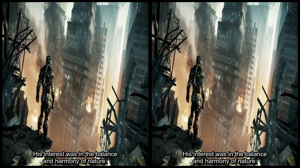

    Sorry for being completely out of topic but, from which movie is this screenshot?
    On topic: I have an LG 3D TV and subtitles produced by 3D Subtitler (with side-by-side movies) work like charm.
    (edit) It would be virtually impossible to make it through spacing because
    1) Even if you do manage to match pixel-to-pixel the correct positions for (say) the first subtitle
    this won't be true for the second!
    2) Using fonts you don't have that much control (that is required) over the exact pixel that you must position your subtitle
    Btw, Z-depth isn't much of a trouble. Provided that you have the correct placement for right and left subtitles you just add between them some space (meaning expand equally to the left and to the right for example 10 pixels) and there you go. You have negative (towards inside screen) zdepth !
    (edit 2)
    If it could be done with a lot of pain (which i seriously doubt), your only shot would be by using monospace font.
    Again, I seriously doubt it.
