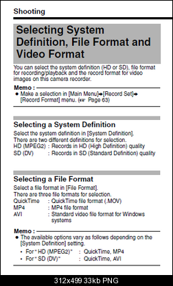

    I think there should be a recording option to record to MOV wrapper directly in the camera (instead of MP4)
    yes it's in the manual, switch from mp4 to mov - same quality, different wrapper.
