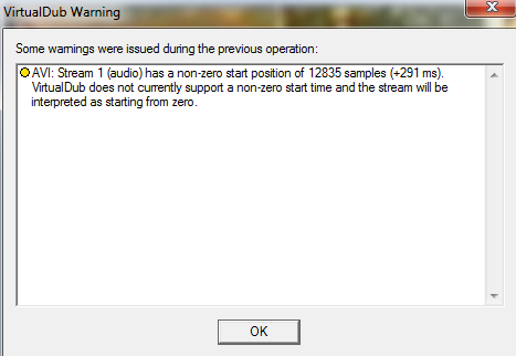

    Ive capped a homevideo from vhs to lagarith avi using Virtualvcr, then im going to clean it up in virtual, i add filters, and says save as avi with lagarith compression... But the result file has audio out of sync???
    Thats what it says when i open my file in virtualdub...
    Whats wrong here?

  2. Can you use Audio -> Interleaving -> Delay Audio Track By...

    Yeah but how go you know what to delay it with?
  4. How about 291 ms? If that's not right you'll have to eyeyball it.

    What format is the captured audio? It should be PCM (uncompressed).

    How can i see that ?
  7. Originally Posted by Asesinato View Post
    That rings a bell. From vague memory you should run the file through "AVI Offset Calculator". It will tweak the file and allow virtualdub to open it without complaint and maintain the same standard of audio sync as was in the file intially.

    I tried using the 291 but that didnt help at all on the capture... Is there anyway to make virtualdub accept the file with the changes that virtualvcr made???

    Allow the file to open in VirtualDub, even if errors. In the top menu bar, click "File..." then "File information..."

    It is PCM (uncompressed)

    http://www.users.on.net/~alfalfa/files/AVI%20Offset%20Calculator.exe
    I recommend making a copy of your source file first. The open the copy with avi offset calc, tick the kill offsets box, click calculate. It should allow virtualdub to open the file without complaining. You will need to apply the offset in virtualdub to put the audio at the same sync it had before the avi file was tweaked.

    I used that program and added the corrected screw in the audio delay in virtualdub but it didnt help at all...
    The capture file runs without problems but when i open it in virtualdub and adds filters the new file is out of sync

    Are you saying the audio seems out of sync during playback in VirtualDub while you are running your filters? Or is audio out of sync after the filters have been applied? During the time you actually apply filters in VirtualDub, the filtering action takes up time and the audio can seem out of sync (VirtualDub is busy using most of its CPU time trying to apply filters, not acting like a movie player).
    Something else to do with this problem is the way you open the orginal captured AVI in VirtualDub. I almost always open an AVI file with a script in Avisynth. Example:
    AviSource("C:\Videos\NewCap.avi")
    AssumeTFF()
    ConvertToRGB24(matrix="Rec601",interlaced=true)
    Such scripts are designed to override some of the assumptious that are made by VirtualDub when you open an AVI directly, witjhout a script. There are many open statements similar to "AviSource", but these depend on the specific type of captured video. There are also audio control commands. But without a sample of your original unprocessed capture, we can't be more specific.
    Then just eyeball the difference between the audio and video and enter whatever value you come up with.
